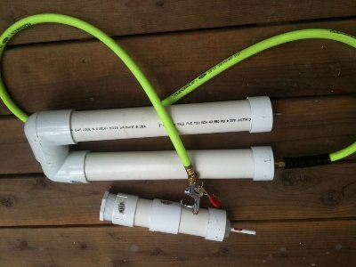

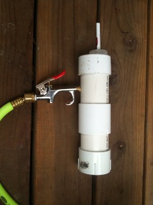

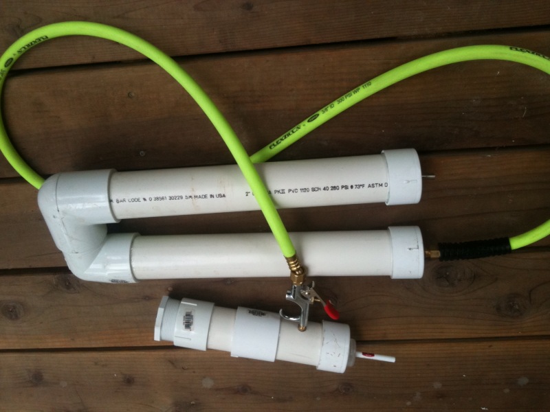

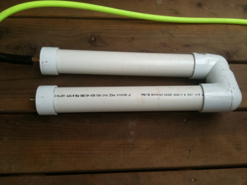

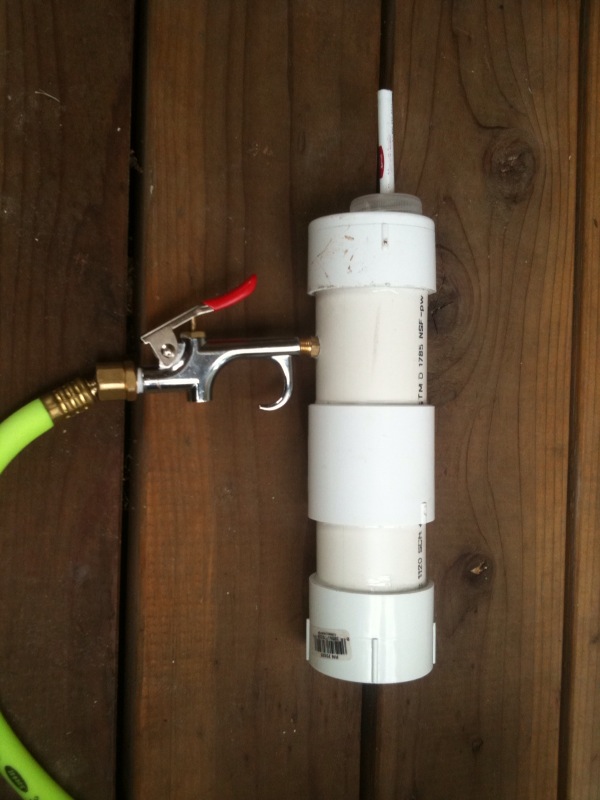

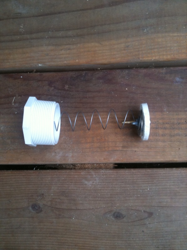

Hey, I've recently been having trouble with my BBMG with regards to getting it to fire. I pump the air chamber I have constructed out of pressure rated PVC pipe up to 120 PSI through a shraeder valve I have installed in one of the end caps of the pressure chamber, but when I pull the trigger of my blow gun valve, I hear air rushing out of the barrel, but no BBs. My device uses a vortex block made out of wood that is inside of 2" diameter pressure rated PVC like my air chamber. The plunger system connects to a threaded adapter on the end of my gun by screwing into it. I have tested my system for leaks but I have found none. What am I doing wrong?

I cannot see how the vortex block works. I really can't help without more details.

Either there is a problem with the block or the bbs are jamming. Try taking the plunger off or loading less bbs. Give it a shake before you fire it.
Remove plunger, try firing in different orientations and shaking.
Add plunger again. If it does not fire, use the weakest spring you can find.

Great news guys! I fixed the problem on my own. It turned out I was simply adding too much ammunition to my gun, which resulted in the inability for agitation to be reached, and in turn, no venturi effect. It works great now and fires about 100 rounds per second! Thank you for the feedback! I will post pictures and maybe a video in the photo gallery sometime soon. Thanks again!
