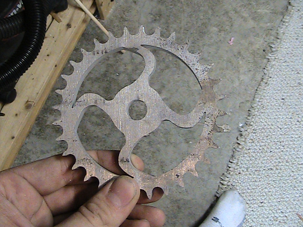

Cheating! it certainly looks good though. But it can`t be a efficent weaponmitsubishi water jet

That immediately conjured up visions of this:SpudFarm wrote:my 10 Year old cousin

tumbling = rotationD_Hall wrote:Once the sabot releases the shuriken will start to tumble almost immediately.

I have thinked of making my own shurinken's, but as im good with bo-shurikens, havent seen a point making those start shaped ones
Est Sularus Oth Mithas
True, potatoes aren't all that good either but it is the primary ammo of the spudgunner. It's still fun to see them "fly". If JSR's device could impart spin, it would work fine. We got them to stick in chipboard etc. You need to make them from 4140 heattreated or case harden mild steel as the points get beat up badly in a few minutes.D_Hall wrote:Lacking a means to induce rotation, the results would be poor to say the least. The basic shape is not aerodynamically stable. Once the sabot releases the shuriken will start to tumble almost immediately.
