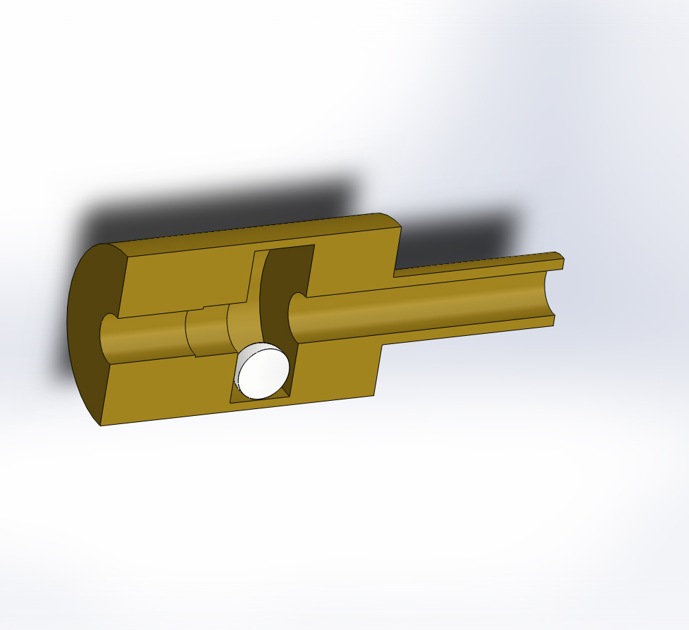

jackssmirkingrevenge wrote: Haven't found the BB yet :roll:
Speaking of which, was it you who had suggested vaguely similar idea by PM a couple of years ago?
Yeah, here is the relevant part of the diagram.
You can basically ignore the red parts, since they're just gaskets and are not really necessary in this design. Pink is/are bolt holes

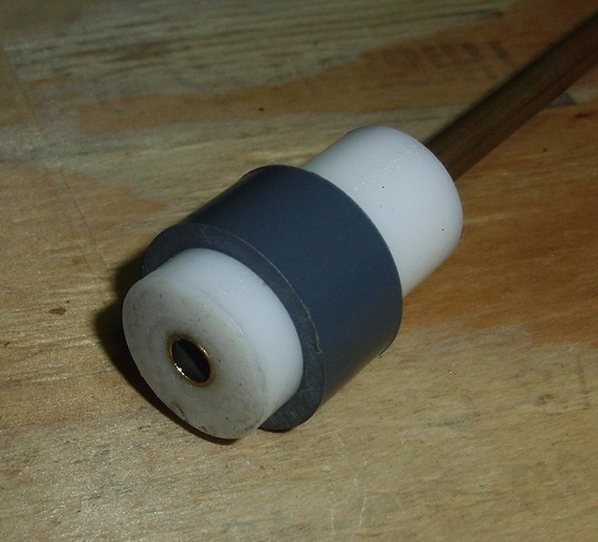

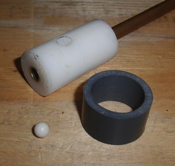

prototype v1.1, same concept but made a little differently.
- Instead of a screw, a collar keeps the BB in place and seals off the porting, this should resist the blast better.
- A brass inset is added to the exit end of the unit to ease the passage of the projectile.

The bb will drop naturally by gravity, so if the suppressor is accidently mounted with the bb housing tube pointing upwards, what will happen :? :shock: It´s crucial for me because I´d like to use it on my future hybrid rifles, not a steady base mounted hybrid.
I´m really interested now, all these parts looks possible for me to make, humm...
Have any video for us to "hear" it working?
Sun Feb 26, 2012 1:59 pm
wyz2285 wrote:The bb will drop naturally by gravity, so if the suppressor is accidently mounted with the bb housing tube pointing upwards, what will happen :? :shock:
The housing is drilled straight through so the BB will drop into one side or another. I tried turning it around and the BB will always fall to one end. To be extra sure, another hole drilled at 90 degrees will make it virtually certain that the BB will not be in the way.

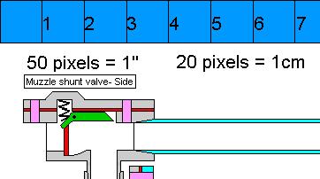

I was thinking about mod a little bit your piston shut-off valve design by adding a light spring...
Too complex for its own right. If you're so worried, why not have a continuous groove like so, easily made by adding endcaps to a pipe:
Great Idea :idea: I will try it out! :D
