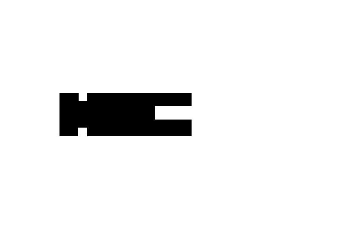

Can anyone machine the pump head? I need the total outer diameter to be about 1/32" under 3/4", and the oring groove needs to be 1/8" deep, and 3/8" long. Total length needs to be 4", and I need the back part to be drilled and tapped to 7/16" for an all thread rod. I don't care what the material is, as long as it doesn't melt with the pump heating up. Any idea on what it would cost? I am located in Alabama, USA and shipping needs to be low.
Pump head 2.JPG (7.22 KiB) Viewed 4380 times

1/32" under 3/4"
23/32"nds
Are you sure you want the groove that long?
The back would be on the right? The slotted skirt? How deep do you want the hole? Are the slots representing the hole or do you need the slots?

Duh, should have been a bit more detailed. I am a bit rushed for this though... The back part is indeed the right side. I need it about 1 inch deep. If you want to, adjust the oring groove to what you feel would be good to make it like a check valve. The slots on the right side are representing the hole, and left side is the o ring groove.
Tue Mar 20, 2012 5:30 pm
With the way work is going I could get it out the door in approx 2 weeks for $30.00 shipped. It will be Aluminum. Your looking for a "floating o-ring".

Apparently you need to have the exact right size of o ring for it to act like a check valve. If its too small it will only start to act like a check valve part of the way through the stroke. I was reading that on another forum, somebody said that it happened to them with an o ring that was too small.
Would it not work if you had the piston (with an o ring to always be sealing) pushing the air through one check valve on the bottom (flow direction out of the pump) out to the cannon and when you pull the pump handle back up then it sucks air in from another check valve also at the bottom (flow direction into the pump)? It would be a whole lot easier to make.
