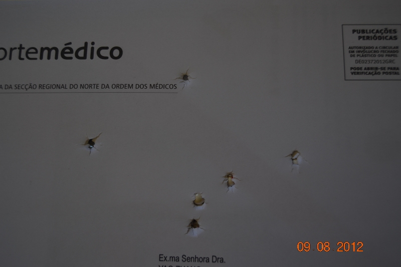

I have steel bbs and if this gun really work out well, I may use a pellet gun barrel. But for now 0.40g bbs are accurate enough for up to 50m.

Test made at 8 bar, 0.25g bb.

Finished the reload/magazing block, also added a homemade hop up, worked like wonder
with only 5 bar I was able to have a effective range of 40m reliably.
