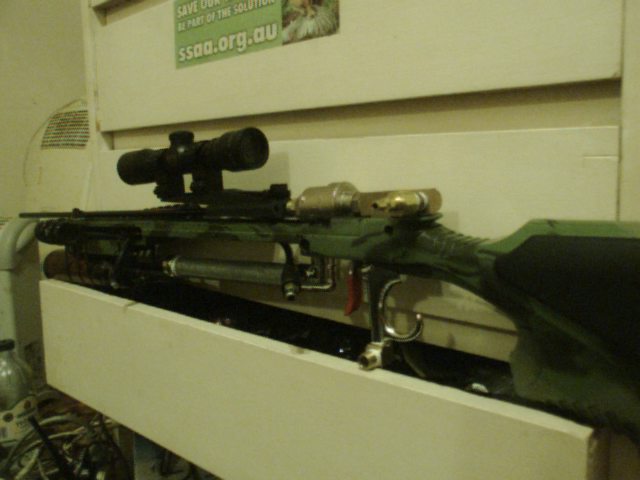

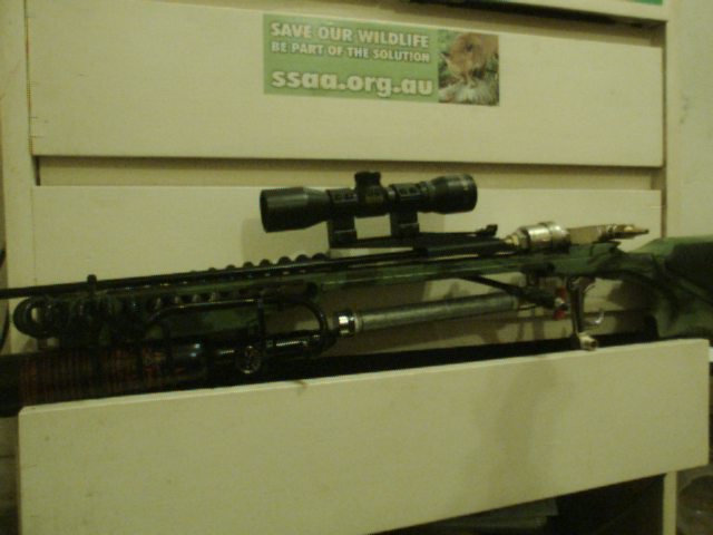

My first qev rifle, not quite finished yet,... here's a few pics

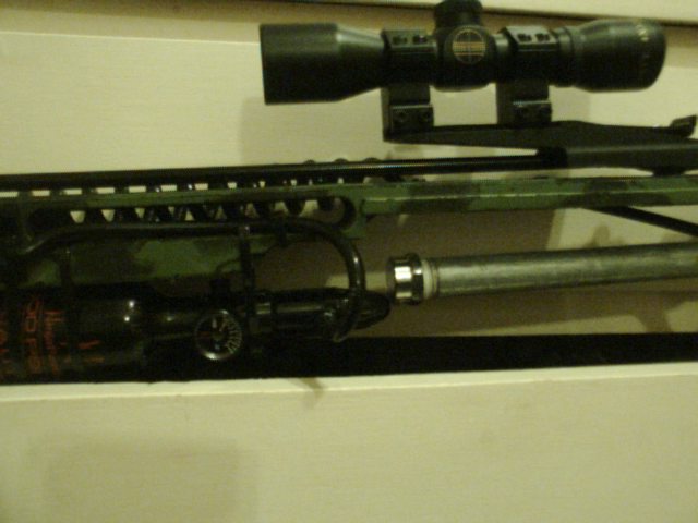

just getting a better look, thats a huge chamber volume for 6mm? dont think you will need heaps of pressure that way. im running about 30cc @ 250 psi and going through paint cans with steel bb's but need more volume i believe for my C-B ratio

thats very niice you should make interchangeable barrels a 6mm barrel and a 4.5mm (.177) barrel

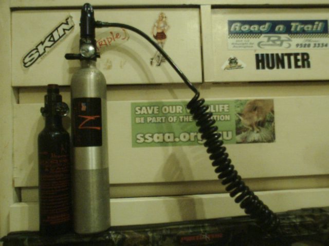

I have 2 ninja regulators with remote lines. One is
300psi regulated and the other is 800psi regulated.
Do you play "far cry" on ps3 lol,.. i have that game

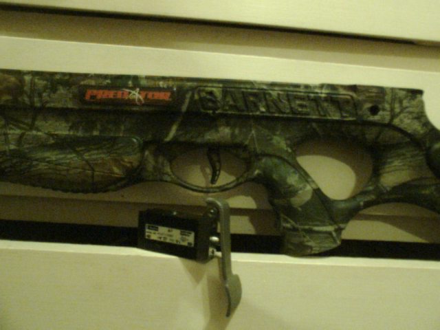

Yes, i want it to be semi-auto. it will have 300psi regulated air supply from
the paintball tank eventually.... I got a couple of those parker 3 way valves
for triggers you mentioned a while back too, should i be using them for semi-auto
instead of the blowgun trigger thats on it now?..... I put that blowgun trigger on because
it was easy to fit to the stock, and i also wanted to test it out with my compressor to
see how it shot with 100psi.

Yup, for semi auto you want to connect the 3 way valve to the rear of the QEV, then leave one port open to the atmosphere, and connect the other to the regged air supply.

Okay cheers jack, in that case i think the hardest bit will plumbing in the the 3 way trigger/valve to nicely suit my stock i reckon.... Can you use flexible hpa type tubing to plumb the 3 way valve in you think?... Also i have another pre-maid (Barnett predator) crossbow stock i want to turn into a air rifle as well, so i'll check em both out and see what suits what the best.
paintball tanks, remote lines etc with "ninja" 300psi SLP regulator,  and a "ninja" 800psi regulator on the small bottle, is how it come brand new.
"Barnett predator" crossbow stock and parker 3 way valve trigger
