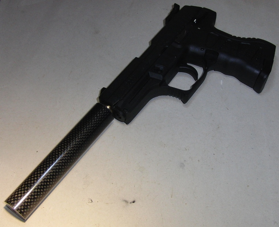

Some of you might remember the rather primitive suppressor I had made for my Anics A3000 "Skif" CO<sub>2</sub> pistol using lego blocks as baffle separators:
I decided to revisit the idea taking advantage of my improved fabrication facilities, herewith the result. Chopped off part of the plastic barrel sheath and epoxied on a brass sheath with a male 1/2" NF20 thread on the end, then made a 5" long 1" dia carbon fibre suppressor to fit, much smarter now

hehe nice! how effective is it?
Est Sularus Oth Mithas
No idea, no CO<sub>2</sub> in stockjakethebeast wrote:hehe nice! how effective is it?
