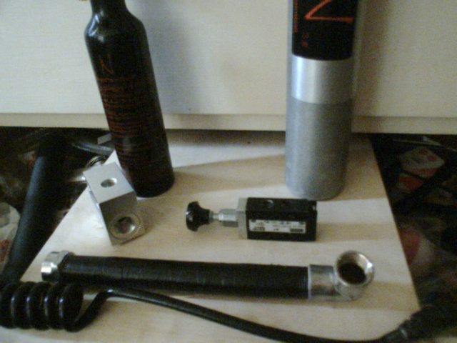

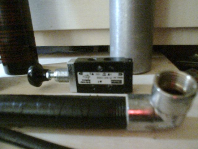

Here are some photos of the main parts i use for my semi-auto qev rifles.
I use a 6mm barrell and 9.5mm.
All the gear fitted to my old crossbow stock
parker 3 way valve ( i got this one cheap around $30)<br />There are cheaper brands on ebay if you look around.
ninja paintball tanks, regs and remote lines (around $100 for the small tank, reg and remote line.<br />Half inch piece of galvanised pipe for &amp;quot;firing chamber&amp;quot;<br />This &amp;quot;firing chamber&amp;quot; is a little long though, a<br /> 200mm length is plenty for what you need.
Half inch piece of galvanised pipe for &quot;firing chamber&quot;
This &quot;firing chamber&quot; is a little long though, a
1/4 alloy qev valve $12 (ebay)
