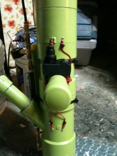

So, I built this about a year and a half ago. It's not anything too special and I am posting it more as a warning than to "Showcase" it
Stats:
Chamber- 4" sch 4 PVC, 30"
Barrel- 2" PVC, 60"
80mm chamber fan run off 12v battery held inside the body.
Ignition- Dual spark, run off an electric BBQ lighter.
Propellant: Metered MAPP gas
HGDT gives me an approximate FSP of 600 using MAPP gas. However, the little Devil on my shoulder told me (after using NO2 "safely") that an additional input of metered Oxygen was a good idea..... IT IS NOT.
Yes, Oxygen/MAPP is fun to shoot. No, it isn't meant for non-metal cannons
YouTube video of the cannon shooting with Oxygen/MAPP:
This was before the last picture. Anyhow, I'd like to make an aluminum combustion cannon using MAPP/Oxygen. I know I'll be advised to "just make a hybrid", but since I am relatively new to all this, I'll take smaller steps, please.
That being said, any advice on how to build an Oxygen/MAPP combustion cannon that can be used later on as the foundation of a hybrid?
Sorry for the poor picture quality. Hmm, who could the last picture be for?
*The cannon was rebuilt after failure.

If the cannon was rebuilt, why not post the rebuilt version too?
Your post in your pneumatic thread seems to indicate that you feel you "can't compete" with cannons like DYI, Larda, and Gippeto's.
Welcome to the club.
That's no reason not to post all of your work. I happen to think this cannon is really well built and would be interested in seeing a rebuilt version. Did you get the layout inspiration from Klugeboy's BFSG-4000?

Nope. I'd never seen Klugeboy's work until just now on YouTube. Man, that guy likes heavy projectiles. The chamber fan(s) he uses are far superior to my Radio Shack Rave Fan. I have a fan stripped from an old nail gun I plan to use in a 3" chamber for aforementioned metal combustion launcher.
The picture of the exploded cannon is the old version (2 separate metered pipes for MAPP $ O2)- this version has gas bottles attached with clamps. Pretty ghetto. The other pics are all of the cannon post-rebuild. I know the chamber is a bit aggressive, but I love boom-boom.
****Another VERY Important Warning: Don't bring your cannon along with you on your honeymoon (unless your new bride suggests it- mine did not). Seriously, I did that a year ago. Not good.

Wow, glad you're ok.
So after that explicit warning, you still want to mess with oxygen?
Don't mess with oxygen.
Hybrids aren't as complex as you think. My first one was made out of rubbish: http://www.spudfiles.com/forums/mini-hy ... 21655.html
