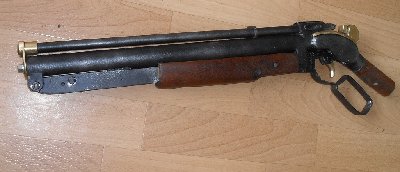

Update...
I broke it..
With an angle grinder...
:D
Now that I have a new fridgy...I feel the urge to convert this gun into a PCP pistol.
I'll make a stirrup pump for it later to be independent of the powergrid..
My other gun, Old Shatterhand, will also be converted and I think i could use the pump assembly on that build.
I chopped off the front, I was sure I wanted to...I'm not sure on how the reloading will be done.
I'm leaning towards a Girandoni block...with parallel magazine...but with the block not sliding sideways, but rotating around the reservoir at every pull of the hammer.
So...a revolver..with an added twist. :P
So..Here's what she look like now...compared to what I plan to do with her:

Hum how do you cock the hammer now?
Netherlands
Posts: 3496
Tue Mar 19, 2013 2:51 pm
Now?
The lever also cocks the hammer, but I can also cock it by hand.
I do not like double action.
BTW:
'Doubts have been growing in my mind about wether or not the pump actually reached the kind of pressures a fridgy will.
it would not surprise me if power actually went up by this mod.

Sorry I meant when you remove the lever. By hand then? I remember the reload was also done by the lever, will it be madd by hand too?
Netherlands
Posts: 3496
Wed Mar 20, 2013 1:08 am
The hammer will be cocked by hand.
cocking the hammer will pull the "cilinder" so the hole lines up with the parallel magazine and then the hammer disengages from the cilinder wich returns into position under springpower.
Or so I hope..we'll see..
Right now I've just cut the lever short so it's just a triggerguard.
I can still operate the gun as I did before.
I tried the gun at 20 bar ....seems to have about the same power as before..
But now I can go up another 20 to 30 bar :D
