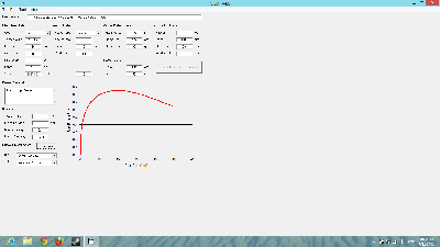

Well after reminding myself the existence of epoxy I machined the parts for a hammer valve.
It's a simple valve, yet steady to take anything up to unregulated co2. Obviously I'm keep going to try to make it work with regulated air, 10 bar.
I did a GGDT, using the dead space as the space needed for the air to recock the hammer, with a .20g bb I got a maximum barrel pressure of 0.9 bar, should be enough to push the hammer back to position.
Anybody see any flaws in the numbers I used?

I see .02 grams for ammo weight instead of .20 which I think is a flaw 8)
