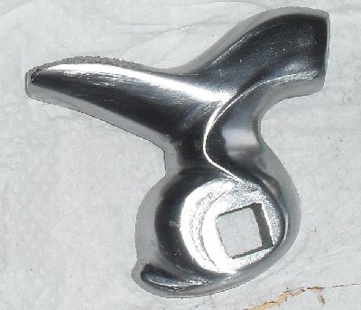

I drilled two small holes, or dimples if you will, in the back of the hammer and inserted ballbearings.
Runs smooth as a...as... eehm...asif it's on ballbearings...
I made a tumbler or sear to lock the hammer in cocked position...took me WAAAAAAAAY longer than I imagined...
Just about everything gets in the way in the tiny space but after a lot of tinkering I figured out what the shape should be to both work and fit in and around everything....Made 3 prototypes and I was up till 3 in the morning trying to figure it out...

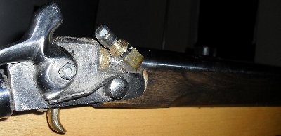

So...trigger is roughly done...
Now it's time to start shaping some wood.
More than half the weight of the original block was removed to shape the front section.
And I haven't even finished the final fit onto the action.It'll move back into the steel as I cut out the exact shape needed.
I used a speeddrill-bit to dig out a channel for the barrel to fit into by overlapping the holes.
That took care of the bulk...
Then I took a piece of the original forkleg the barrel ( reservoir really) is made from and sharpened it.
I attached a bolt as a makeshift handle and voila!
A woodplane in the shape of the barrel.
Worked wonders if I do say so myself.
It enabled me to cut a long halfpipe-like channel from the wood.
Then I used a regular woodplane, a grinder with sanding discs and finally 120 grit sandpaper to form the front-stock.
After that I tried what I had been wanting to do for quite a while...although I had no idea how it would turn out: Staining the wood.
What did I use?
Liquid shoepolish ofcourse!!
And I oiled her up with some cutting oil.
Turned out way better than I had imagined!

I made a shoulderstock...took me two nights...
Still rough, but I still stained it.
It'll help me to visualise what I need to do.
After final smothening and sanding I'll rub some more shoepolish on there..
I think I pretty much nailed the overall shape though.
It already looks like a real donderbus.
That's what they were called you know.Not what the English thought we called them.
