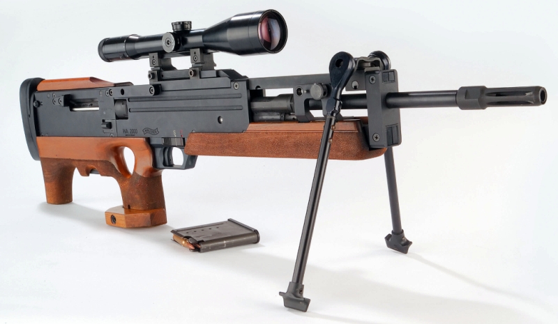

Im planning on building it to look like a walther wa2000
So I guess I better start looking for a nice piece of walnut
