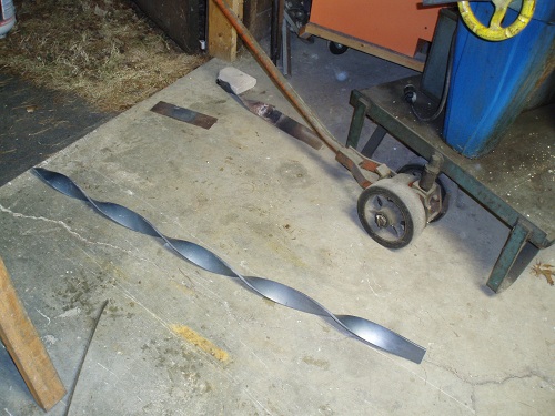

Here's the cutter I machined without the blades made just yet. We're going to try and make a triangular "cutting" rifling.
This is what I just made on the forge. This will be welded to the threaded rod on the cutter. A jig will be made to guide the twisted plate into the barrel, which will be clamped to the end of the pipe.

I am asking for feedback, idea, help, anything you can give me. I'm not 100% sure this is all gonna work, especially the rifling and the shells concept.
