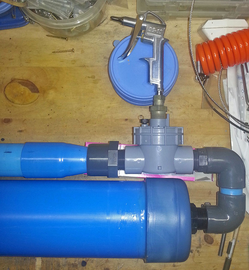

ok so I managed to get some pipe for the tank, but they were out of stock on 90mm pipe so I upgraded to a 110mm tank.

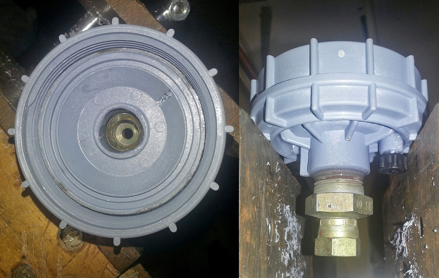

I looked around for good quality tire valves, but couldn't find bolt in ones anywhere. I guess I'm just going to make a cheapy work...
This is what I came up with, don't know if it's gonna hold :/

Looking good, with a chamber that size it's going to have one heck of a "whoomph" but it will take a bit of time to fill.

Assembly complete. Pressure testing tomorrow night. Hopefully fire my first slug out of my first gun this weekend...
Here's a closeup of the valve and some of the hardware. I forgot to unscrew the constrictive tip from the blower nozzle before taking the photo, but you get the idea. I just hope that valve still works, I gave it quite a bit of hard loving!
B.T.W. Will those screw threads seal tight enough or do I have to glue them as well...?

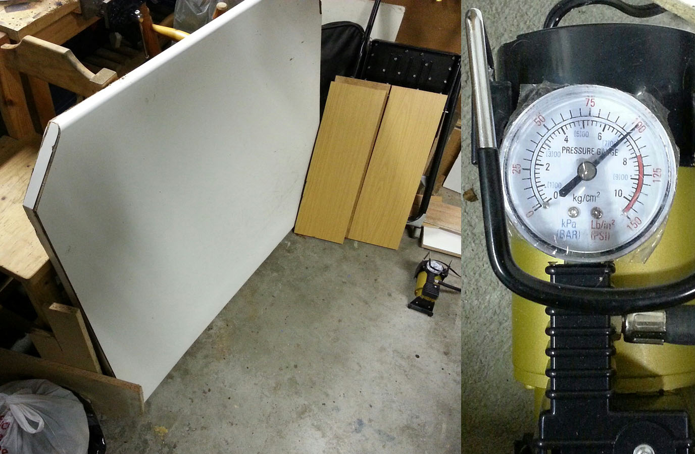

I did the pressure tests tonight and I realized how scared I am of this thing!
At first the gun didn't want to hold more than 45psi due the the leaky screw threads. This was enough pressure to test the modified valve and once I confirmed that it worked I mixed some epoxy and glued the screw threads on.
Decided to set up a barrier for the full pressure test. Gun on the one side, gauge and myself on the other. pumped it to 90psi and waited 5 minutes... perfectly tight, no leaks. Mustered up some courage to reach in behind the board and pull the trigger... Loud PSHHHH! and the gun recoils a bit and slides about 5 inches on the concrete while I'm holding on to it.
Charged it again to 100psi, no damage. Fire again, this time knowing what to expect. Pumped it again to around 40psi just to make sure there's no damage and to do a fire from the hip. I felt a bit like Arnold in Terminator when that icy cloud fired out the front!

Well, where's the photos of fridges full of holes?

Very nice looking! Quite solid too
Assuming you have Sch40 or Sch80 PVC then I believe that your max pressure should be about 150 PSI (with the sprinkler valve), you can safely take it to about 100-120PSI.

Here in South Africa we use Bar for pressure (1Bar ~ 15psi)~NooooooB~ wrote:Very nice looking! Quite solid too
My chamber uses Class 12 PVC which means it's rated for 12 Bar (~180psi). My Sprinkler Valve is rated for 8 Bar continuous use (~120psi) and I'm not really planning on using it over 7 Bar (100psi), just to be on the safe side...
