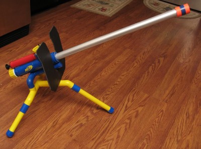

BowerR64 wrote:I, I , I cant stop making these things. :D
When the bug bites, it bites hard :D another great job!

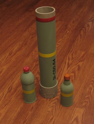

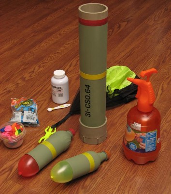

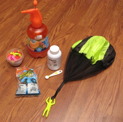

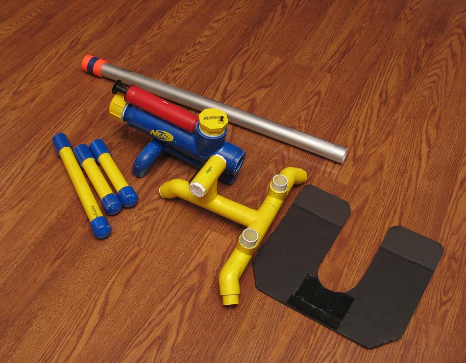

I thought of a little differnt setup, REALLY low power but enough to shoot empty 20oz pop bottles. Alot more quiet and i can do it in the back yard without causing to much of a problem. Unless they think its real now? :roll:
I found this little water balloon tank at CVS, it does 3 functions: fill balloons with air, water or shoot a mist. So it will hold some pressure. I cut the pickup tube inside that pulls up the water so insted it pulls in the acytlene wich mixes with the water. The volume of the tank is about what my 3" cannon uses so i use the same amount of carbide in the tank. Each balloon uses 5 pumps to fill the balloons making the perfect little charge to shoot the empty pop bottles and the little parachute figure. The air to gas is very consistant and WAY more effecient then the cannons wich use 1/4th tsp per shot. This setup will shoot the rockets about 10 times per 1/4 tsp of carbide.
Ill get some video next day it clears up enough to get out and shoot em again.
2 rockets and launch tube
SOme of the parts i used to propel the rockets and chute
This is how the rockets look when charged and ready to fire

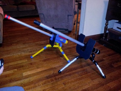

I built one last weekend with my friends son, he is 16 and likes blowing stuff up like i do lol.
Here is how mine turned out.
Sonic Dad carbide cannon together
unassembeled for transmortation
BOth cannons we built together

A frickin carbide Howitzer! I love it. Like always you're paint job is beautiful.
Now is this thing supposed to actually shoot something at supersonic speeds or is the shockwave supposed to be super sonic making an extra loud bang?
What is the little hand pump for?
Edit... I just watched the video... At the end he fires it once and then pumps more air in and gets a second shot. Did I see that right?

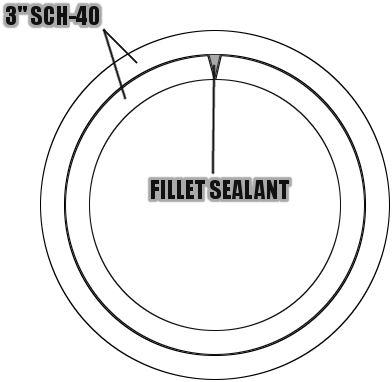

For tennis balls people have sleeved 3" pipe inside of itself after cutting a strip lengthwise out of it... given your short barrel sizes, it shouldn't be too much of a chore (compared to building "full-size" (4' and up) barrels).

How do they fit after you sleeve the 3" and use the regular cheap tennis balls? using the 3" and the kids low bounce balls they fit nice and loose but they are about $1. a ball and after a few really pounding shots it starts to burn the fiber up on the tennis balls
