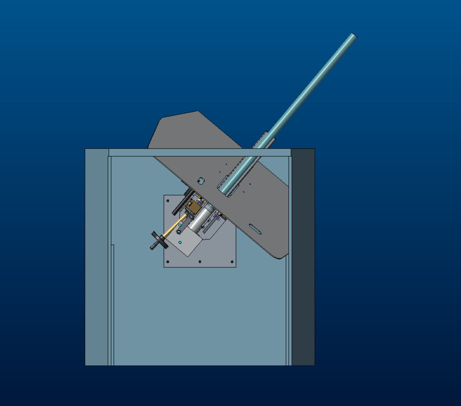

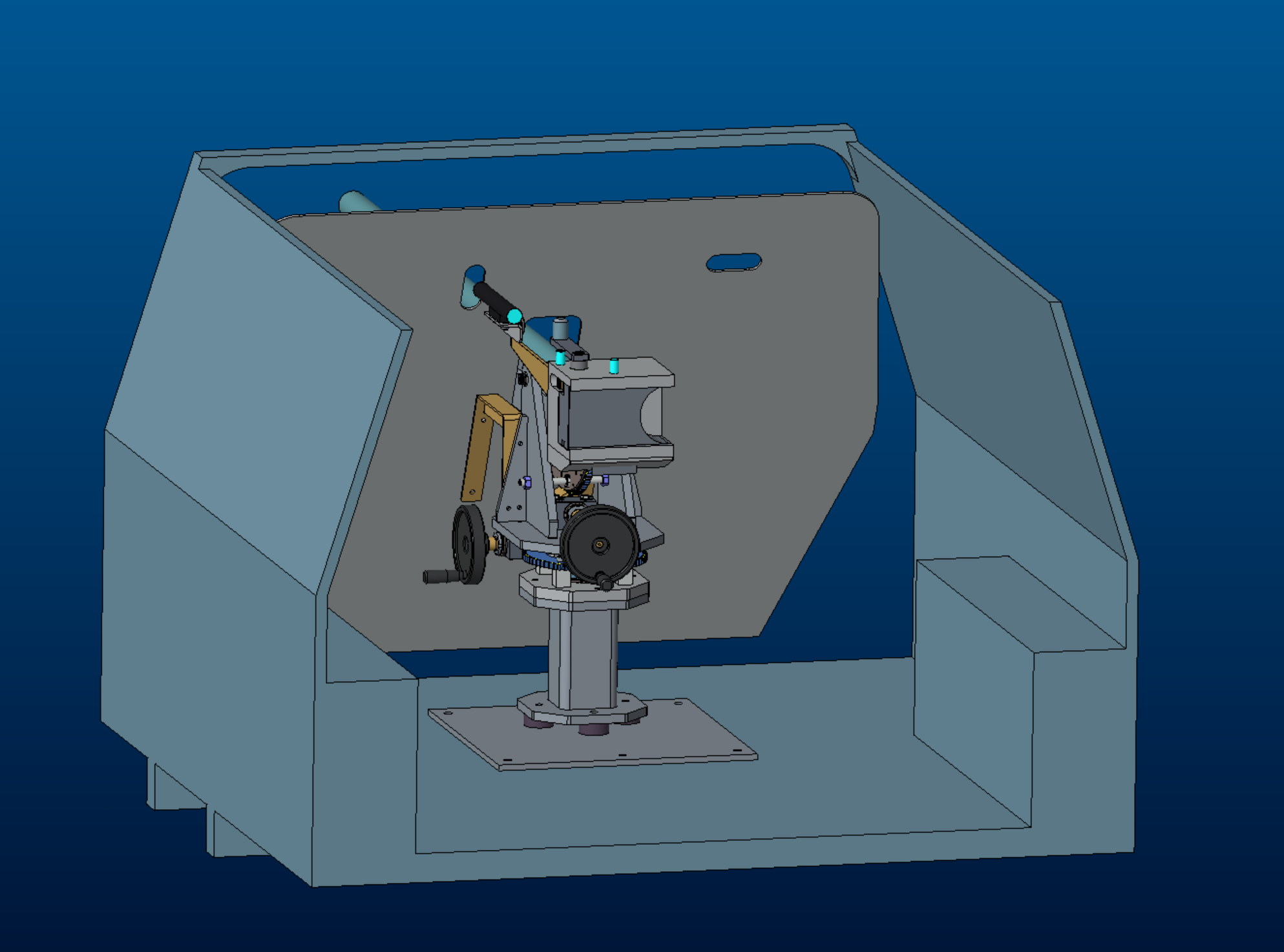

Small update on "Portee" mount. Nissan pickup is available, 3D model with customized gun shield and pedestal is ready. Production and mounting will take 2-3 weeks. There won't be time to make adjustments before the game, so I hope it works at least usably well the first time.

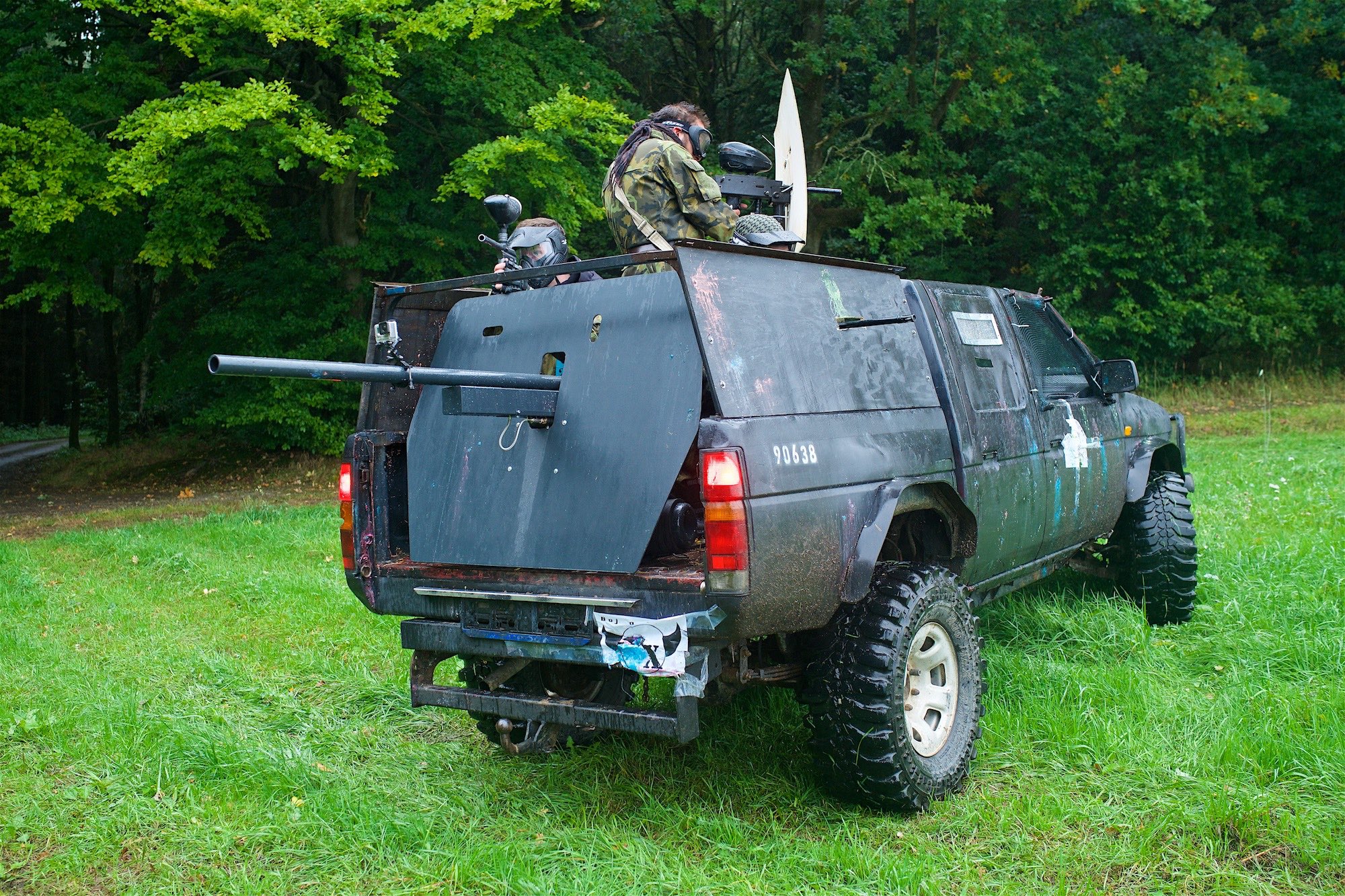

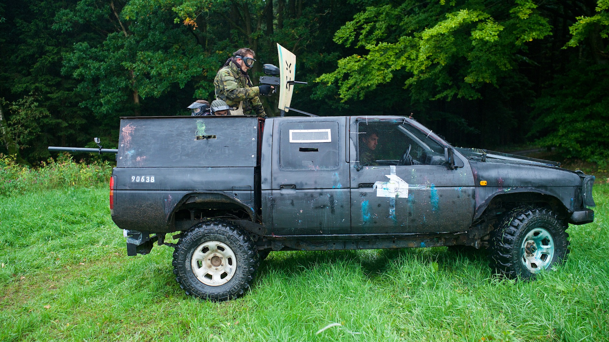

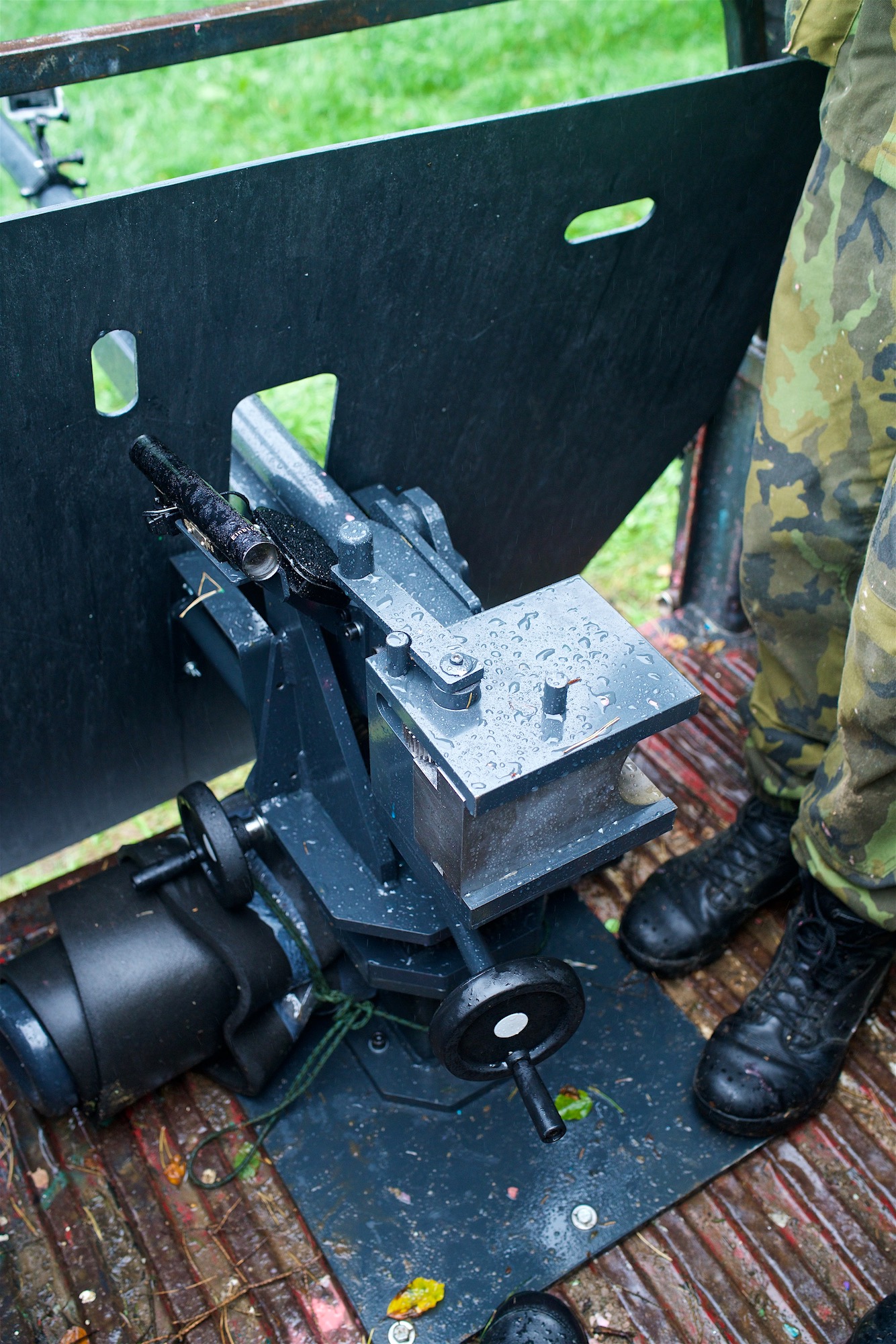

We have just finished live game with our improvised "37mm gun portee". The build and installation and car repair has been finished just before the game with zero chance to test it out beforehand. And all worked! The gun fit on the pickup and the concept proved very promising
Paintball games in open terrain are the most entertaining; when you drive without restrain across fields and woods and villages in such vehicle, it is rewarding even without entering the actual combat
