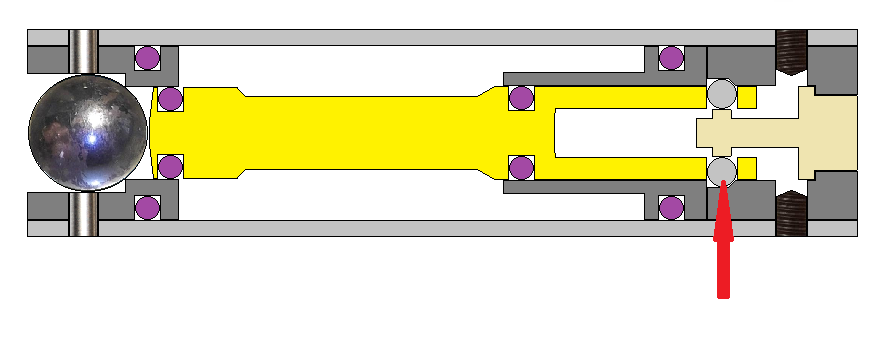

More practical musings, perhaps a mechanical lock is a better idea.
Argentina
Posts: 1064
Location: Argentina
Has thanked: 274 times
Been thanked: 276 times
Wed Nov 29, 2017 10:06 am
It seems a little more complicated, without this being a problem.
Question: What material is indicated by the red arrow?
What are the advantages compared to the previous design?
Note:
There is NOTHING to replace your practice of having seen thousands of these mechanisms .... :|
Has thanked: 581 times
Wed Nov 29, 2017 11:02 am
Those are steel balls, the function is like an airsoft grenade:
They hold the piston in place in the same way that a quick-connect fitting works:
No air is wasted for piloting, and piston release is instant, there is no pilot chamber emptying that will slow the piston down. It's a little more complex to make, but also more reliable and in theory faster opening. If the difference in diameter between from and rear o-rings on the piston is small, the force needed to actuate it will also be minimal.
