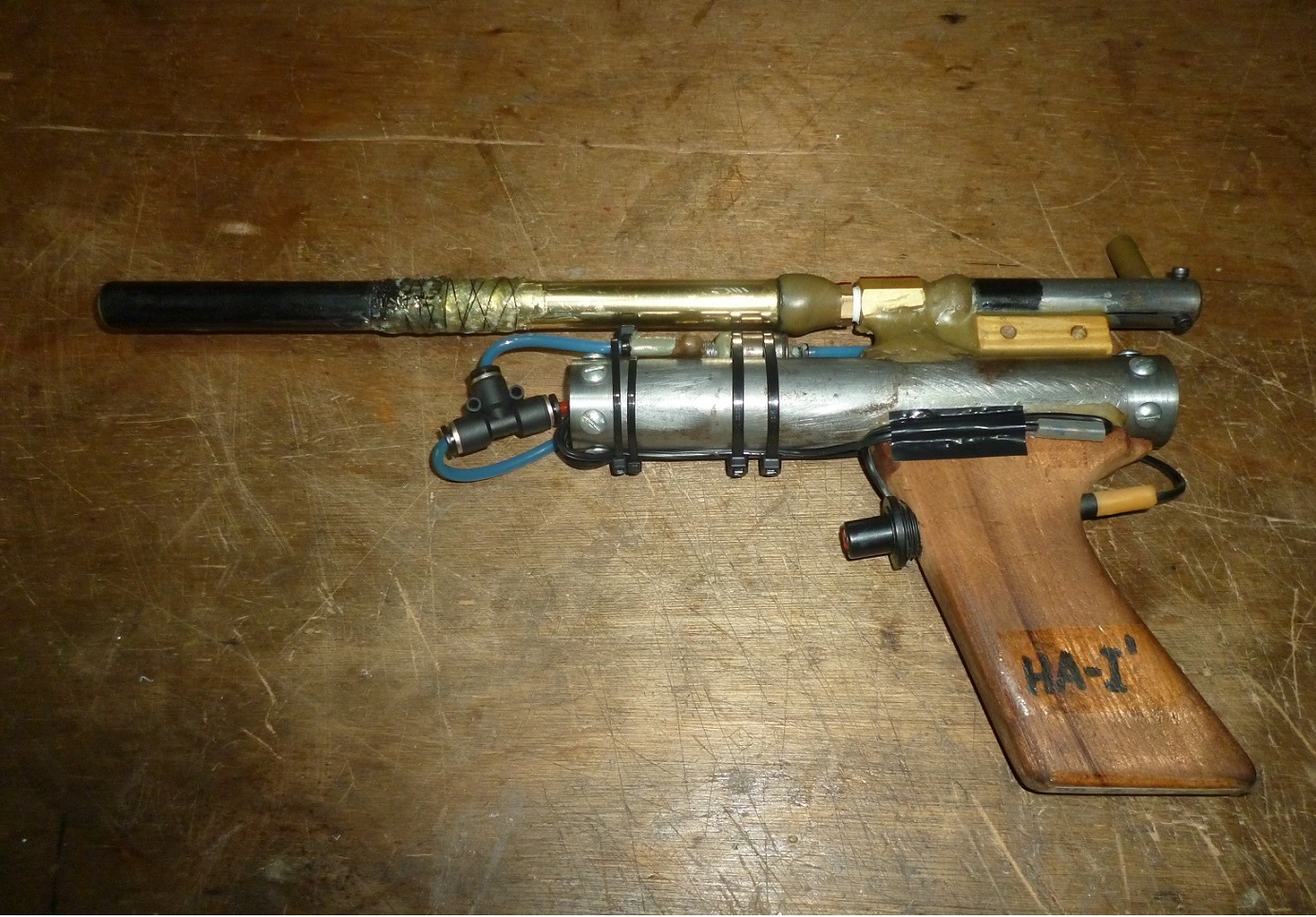

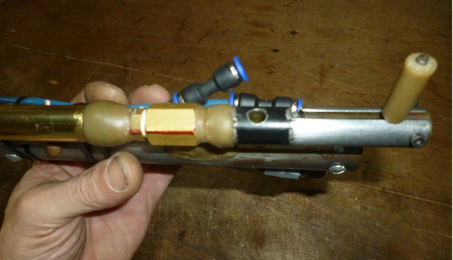

Wed Feb 13, 2019 2:09 pm

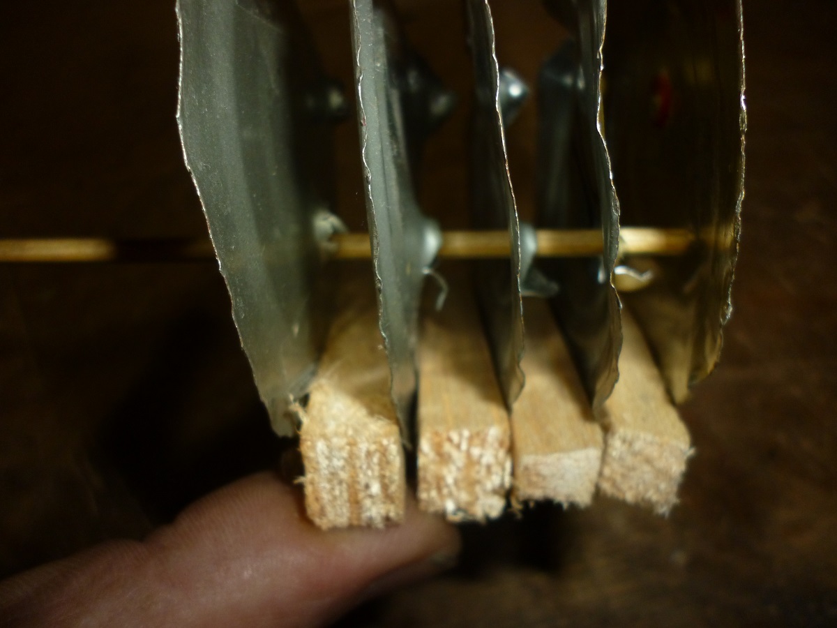

I made a modification to this short weapon. I have tried to include an adjustable holding o`ring and I have added a manual ammunition loading system. Also, I added 10 cm of firing cannon.
The result is that power has increased a lot. I'm working at 5.5X and everything else is the same as before, I mean the spring, the volume of the combustion chamber and the amount of butane gas.
Before, he was drilling two soup can discs and now drills 4 and almost a fifth. The shots were made from distances of 3 meters, in both cases. and with the same ammunition of 1/4 "steel.
Of the modifications, the most important thing is the inclusion of retention, which is responsible for the increase in power. I will include this technique in my other weapons that fire lead or steel BBs.
It is a test weapon, to try different things, that is why I keep it active, and for this reason it is all untidy. The aesthetic objective is not :oops:
I leave some photos of the modifications and the effect.
Has thanked: 581 times
Wed Feb 13, 2019 3:46 pm
That's an impressive increase in performance!
hectmarr wrote:The aesthetic objective is not :oops:
It's got a certain post-apocalyptic aesthetic and is beautiful in her own way ;)
In English we say "pretty is as pretty does", it's the opposite of "no basta con serlo, hay que parecerlo"
I really wish you had received the chrono to be able to quantify your progress with numbers instead of Box O'Truth style experiments, oh well.
Argentina
Posts: 1064
Location: Argentina
Has thanked: 274 times
Been thanked: 276 times
Wed Feb 13, 2019 6:17 pm
Yes, the aesthetic is secondary but personally, I like it. It can be said that it is "horribly cute" :shock:
I almost never make this kind of arrangement to see the force of the shot, but although I do not know the velocity of the projectile, I can see that the energy increases, in a general way.
From what I have observed, the pellets seal more in a barrel with flutes than the bbs in smooth barrels. That's why the difference in energy I see. It gives the impression that the "skirt" or ass of the pellets, expands when the gases or the compressed air hits in it, but in the spherical ammunition, this does not happen.
Thu Feb 14, 2019 7:01 am
hectmarr wrote:From what I have observed, the pellets seal more in a barrel with flutes than the bbs in smooth barrels. That's why the difference in energy I see. It gives the impression that the "skirt" or ass of the pellets, expands when the gases or the compressed air hits in it, but in the spherical ammunition, this does not happen.
This is exactly how they are supposed to work, it's the same principle as a the Minié ball.

Seriously though, look at the deformation before and after firing:

"Heavy" ammunition for high pressure to hit exactly the target! jo jo jo jo :D
It is clear because it seals the diabolo more. Since I never had a compressed air weapon, I did not know ...
