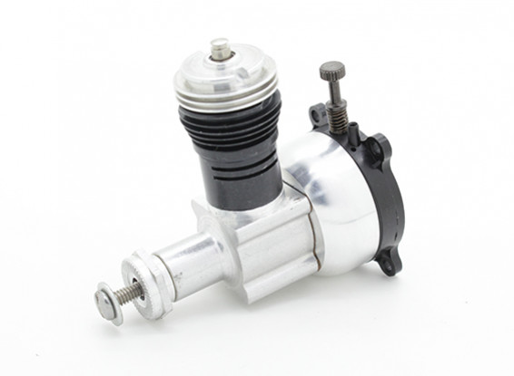

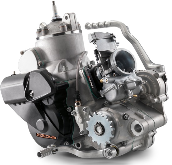

An example that has always seemed educational to me, is the case of the famous glow engine of aeromodelling 0, 49, which is a small two-stroke engine, without carburetor, (in the full sense), without rings, without bolt on the piston. .. a great simplification, which makes it possible to fly some things with an engine that is almost a "functional diagram" :shock:
To my mind, fans have opted for a solution that allows almost anyone to build a piston valve. In reality as a whole, where several factors appear apart from just performance, it is an excellent solution. :)
This "simplified" engine has a few constitutive parts, compared to a motorcycle engine, which has many more and yields more.
Performance itself is not everything. I prefer to evaluate these things based on a more general context, where aspects such as ease of construction are as important as thermodynamic performance or compressed air consumption.
motor 0.49 cu.jpg (25.47 KiB) Viewed 13725 times
