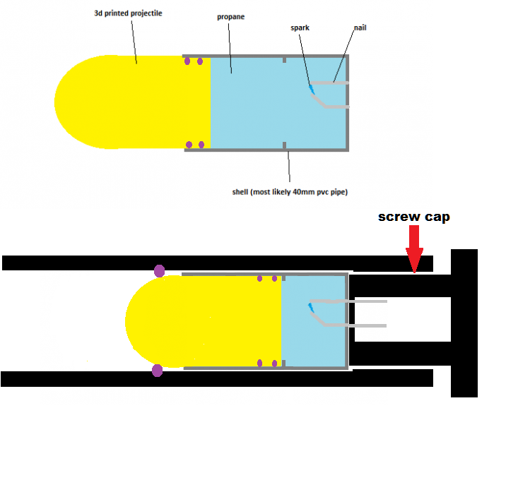

I plan on making propane combustion 40mm grenades. As a first step I want to make the a simple M79 style launcher, breach action and all, to focus on the shell itself. I'll later come to blowback if possible but I want to start easier.
I've read a lot of topics on this forum, and came across this particular one.
The project is awesome but it apparently lacks power.
I designed my idea, it's very primitive. I thought about a normal version, and a hollow projectile to increase a bit the combustion chamber, not sure if it would improve performance or not.
the ignition mechanism will be a piezo, connected through the butt of the grenade, via some metal bits in the back of the barrel, in the part not moving when breached. I used a simple circular pattern to allow one to place the grenade in any position. It could be spring-loaded to ensure it touches the contactor at the back of the grenade when the barrel is closed, but it will be loose of only ~2mm, more of a security than a real spring mechanism.
The goal is to keep operation simple so i like the idea of just using propane, with proper quantities via syringe injection as i saw on this forum. I only will shift to hydrogen or other combustibles as a last resort.
So that's for the ideas i had before browsing this forum. The problem is that from what i've read, my idea would certainly lack power. I'd appreciate if someone had any advice or experience :bounce: the shell dimensions are 40mm diameter and about 46mm length to match 40x46mm, if it's feasible. The projectile size/weight/shape are not determined.

Welcome to the forum!
The issue with an atmospheric pressure combustion is that peak pressure is relatively low, so even if you increase the chamber volume, power is not going to be that impressive. It really depends on what you want to achieve.
If you want to increase pre-ignition pressure, then you're going to have to find a way to contain it before firing, and that's where things get as little tricky.

Fri Nov 15, 2019 11:01 am
jackssmirkingrevenge wrote:Welcome to the forum!
Thanks :D
jackssmirkingrevenge wrote:The issue with an atmospheric pressure combustion is that peak pressure is relatively low, so even if you increase the chamber volume, power is not going to be that impressive. It really depends on what you want to achieve.
Honestly I don't really know what i want to achieve, but like many members of this forum i love explosions, the "thump" sound and things that fly fast through the air :bom: maybe a 15 meters range, firing from a 45 degree angle should be nice (the more the better, but i don't even know if 15m is possible). So with what you said i can right now forget the simple not-pressurized air+propane combustion, it would be too weak to propell a little projectile with a short 40mm diameter combustion chamber (35mm though, cause 40mm is the ext diameter but nvm).
jackssmirkingrevenge wrote:If you want to increase pre-ignition pressure, then you're going to have to find a way to contain it before firing, and that's where things get as little tricky.
This seems like a good solution but as you said, somehow tricky. The only viable solution that comes to my mind, if I stick to 46x40mm shells, would be to add a valve to the shell. That makes the refill of the shells a little more complicated really but more powerful. I'll list all possibilities and weigh the pros and cons of each one after reading all your kind replies :)
