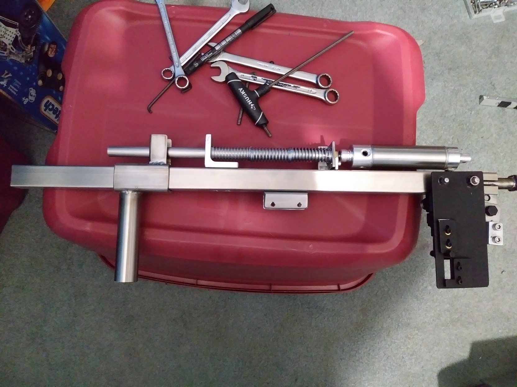

Sat Mar 21, 2020 7:14 pm
A bit of progress, bracket in the middle is for the grip, sprig guide needs a locking collar for the charge handle to push on, trigger not figured out yet or linkage to rear to load.

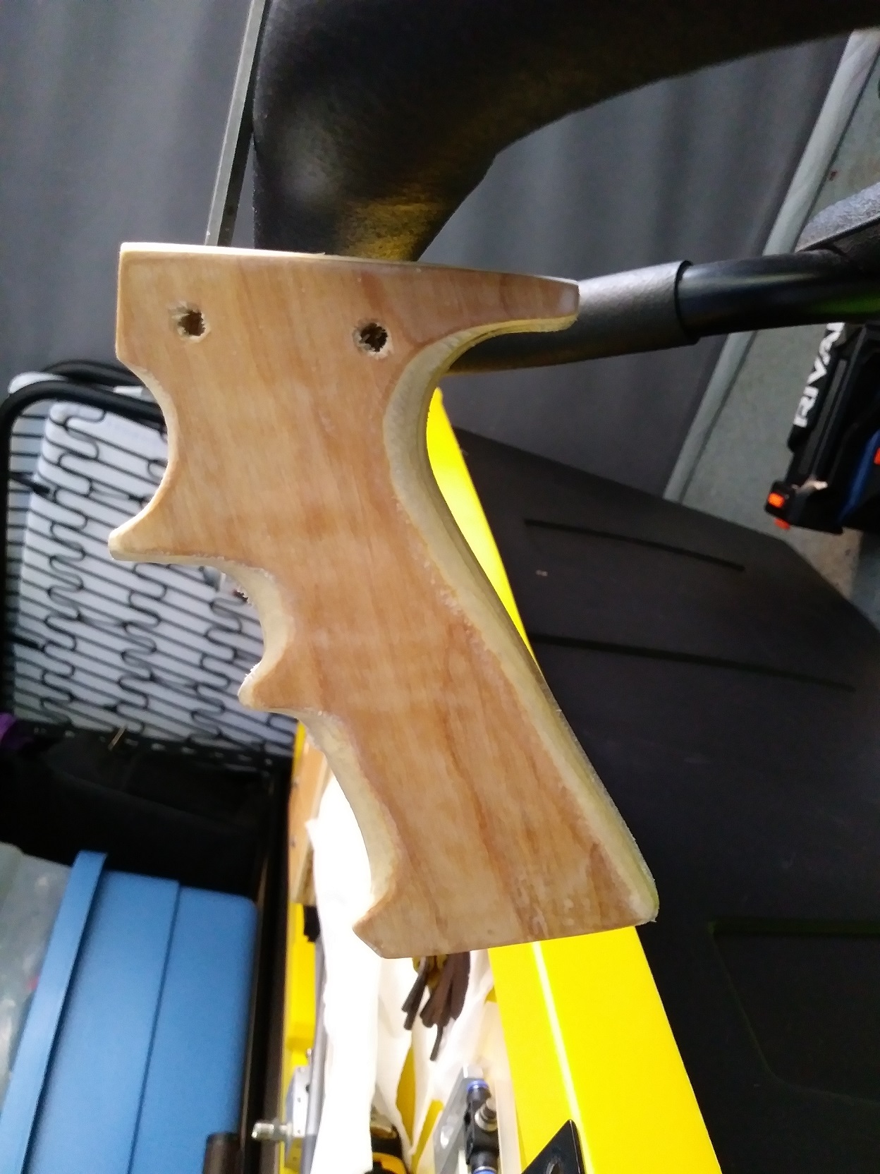

Sat Mar 28, 2020 9:27 am
Grip made from 3/4" plywood.

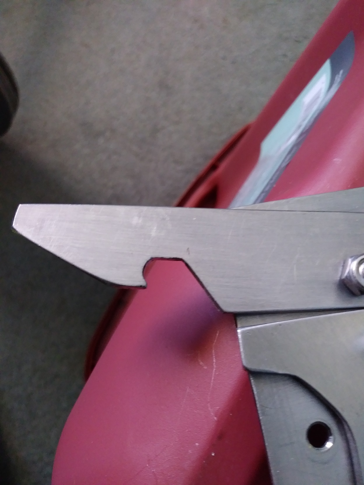

Trigger latch needed a bit of a detent to keep it latched

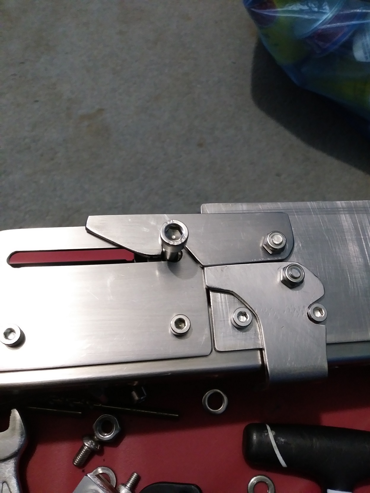

Fri Apr 03, 2020 5:24 pm
More done, linkage from charge handle to rear to be made and trigger needs a return spring, power seems low but that's what I wanted. The springs are about as much as I can push, rearward charging is definitely needed for more spring tension.

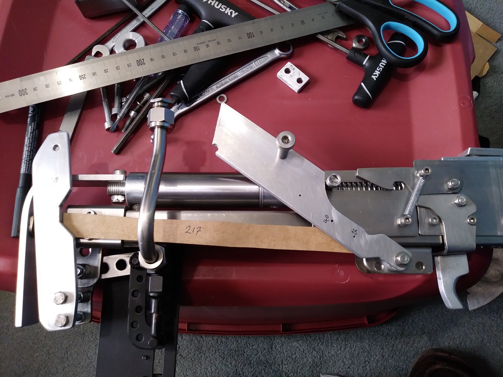

Fri Apr 10, 2020 2:15 pm
Trying to make a different/better system for the spring charge/loading handle, this looks much better than the sliding handle I had at the front. The handle would jam very easy because it was trying to twist as it was sliding, the new handle takes much less effort and will be more compact. Still a work in progress :idea:
