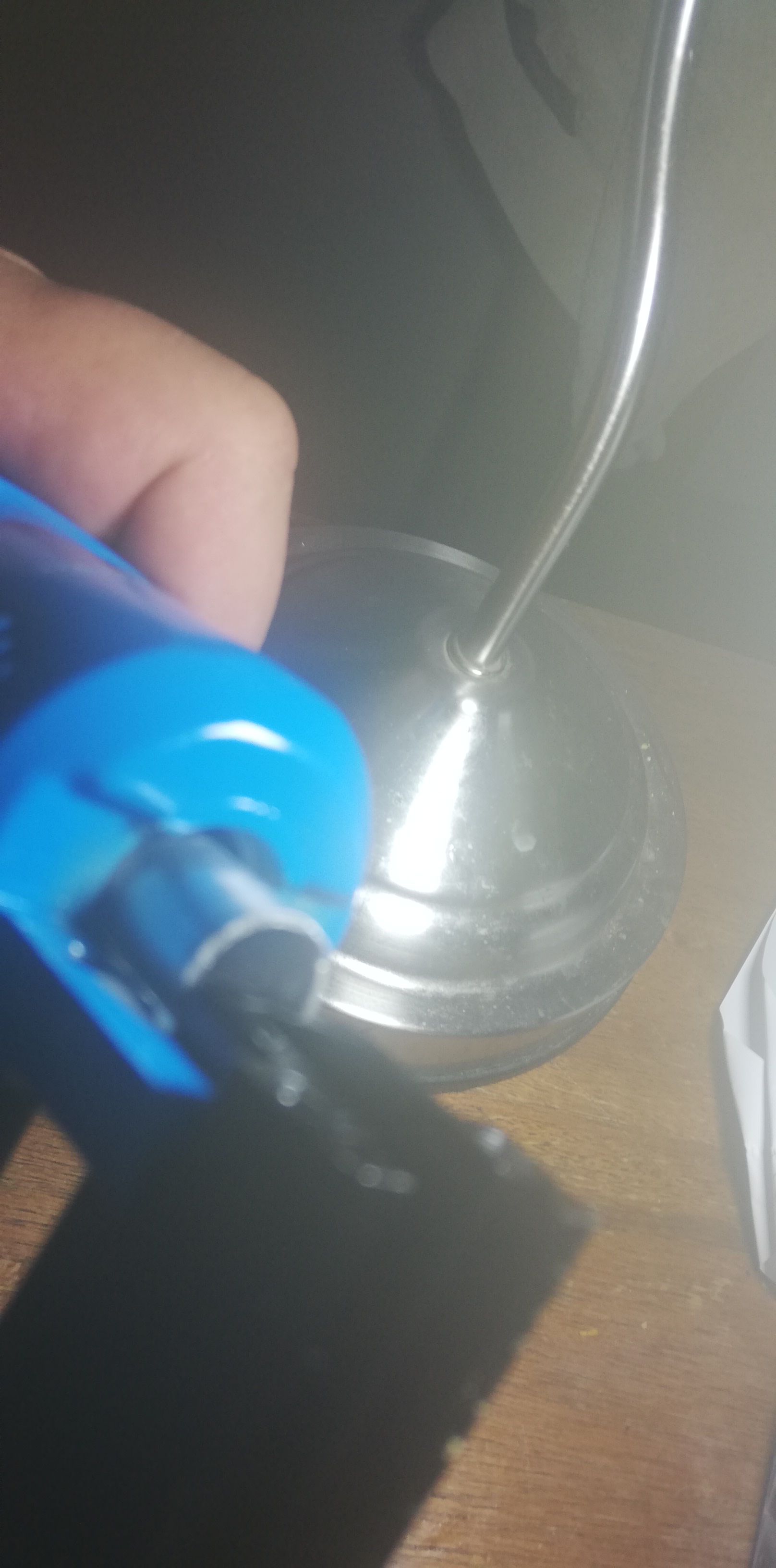

My progress.
Haha.... Mini... incremental.
Just to see how it goes, I
Pulled out piston.
Put Schrader valve bottom handle , used foot pump.
Didn't work at lower pressures.
70 to 90 psi did.
It air hungry, pretty much whole volume gone in one pull.
I changed spring and length in back of piston valve .
Got it to work lower pressure. 40 etc.
What want to do is reduce volume air blown.
Seperate chamber around piston valve from handle. (handle and around valve seems volume expelled. Maybe different if had the staple piston. Any how.
Then think needs small hole in piston valve fror it to fill surrounding chamber.
Then it's where to put hole.
Piston oring is tight fit.
