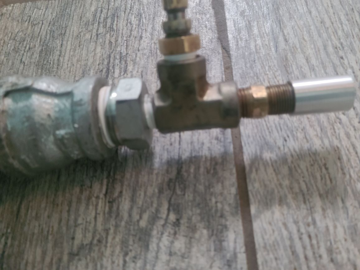

So I've put something together, its a hybrid clone of my phenumatic rifle. Right now they share a barrel but it will get its own dedicated when complete.
For the time being I have had a few successful test shots at 10x using the chart from the forum. They are hard to repeat. But I have had some success.
The gun is made from hydraulic pipe with a work pressure of 3000psi I feel like I am safe to push maybe 50x??
Questions
1• how high would you go on hydraulic pipe?
2• how accurate are the gauges we use for metering?
3• can you ignight a 50x mix with a spark?
4• how to achieve reliable fueling?
5• most cases of a failure i get some smoke out of the chamber when venting, so partial ignition? Am I lean or rich? I am using a 0-300 psi gauge at the moment and it has no resolution.
Let me hear it guys? What do you think. I insist on achieving super sonic.

Since posting i believe i have figured out my issues. I noticed that if I leave the gun sit for roughly a minute before firing it goes off reliably. I increased the chamber volume aswell.
I am in the process of creating a "venturi" fuel mixing system to mix the gasses as the chamber is filled.

So the gun has a piston valve.
If you have seen my other rifle, this is a clone.
The only difference being a venting pilot valve, a spark plug, and the piston does NOT have a check valve.
Because of the identical construction I can use the rifled barrel on both of my projects.
My miss fire issue is due to mixing the fuel, at least this is my conclusion.
Regarding 50x and compressed air, my understanding is that by increasing the pressure you increase the available oxygen? How does the oxygen stop getting pumped into the chamber?
I was on the forums many years ago. I credit larda for getting me into hybrids. Watching that thing punch a hole in 1/2 steel plate was something els. He did use a heated wire, something like a glow plug.
I say 50x because a 10x air/propane yelled significantly less damage than my phenumatic rifle at 3000psi. Same barrel, same ammo.
I cant have a phenumatic that out performs my hybrid 😬

Eventually ill figure out how to quote, and use the forum properly, but for now...
I use a 4500 psi PCP pump for air.
It has to be a mixing problem, I personally attributed the small chamber as why it doesn't mix well. My thought is it only takes maybe 5 pumps to reach 150 psi so not much mixing actually happens.
If I try to fire immediately after filling its a no go. Come back 1 minute later and it goes off with a sharp bang. I will start "upping" the mix this weekend.
Volumetric metering 🤮 math.... lol maybe ill give it a shot if I want to scratch my head for a while.
For me Xpsi + Xpsi is profoundly simpler.
What is the lowest mix i can achieve 3000psi post ignition?

I'm thinking about giving the volumetric route a try. I cant get any real consistency right now. Makes a nice bang when it does go off though.
I dont have any real way to measure the volume at the moment. So for now I'm messing with the pressures. Not sure which gauge is wrong..
