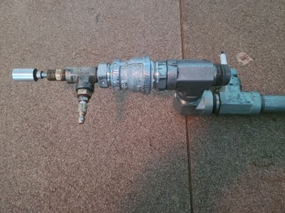

I pre pressurize the hose prior to opening the valve, that way the air forces its way in before the propane can escape.
I'm thinking that as I raise the mixture that the margins become smaller. Giving a larger window of pressure for a stoichiometric mixture?

Once the valve is open the mixture is going to go both ways.
I think you're running lean because of this, maybe experiment with a 15% greater propane pressure to compensate and see if it makes a difference.

I found I have to purge my meter pipe with propane to get the air out before fueling, otherwise the first shot will be weak and funky because the meter has an atmosphere of air in it.

Right on guys, ill keep tweaking things. I think it would be a good bet to lock the fuel regulator in position and adjust air pressure for compensation so I am only changing one variable at a time. One thing I have noticed is that tapping the fuel gauge will cause the pressure to fluctuate by .5- .75 psi. When there is no pressure it reads about 1 psi. Im starting to think I need to replace this gauge. Maybe even the regulator.

So you guys were on the money. I was lean for sure. I think higher mixes helps aswell. I have been successful up to 30x with roughly 20psi propane 420psi air. Now it seems to be on par with the phenumatic counterpart.
I do intend on mounting it on a stock or something of the sort. Like a bulpup configuration. So I rearranged the components so I'm not staring down the relief port any more.
