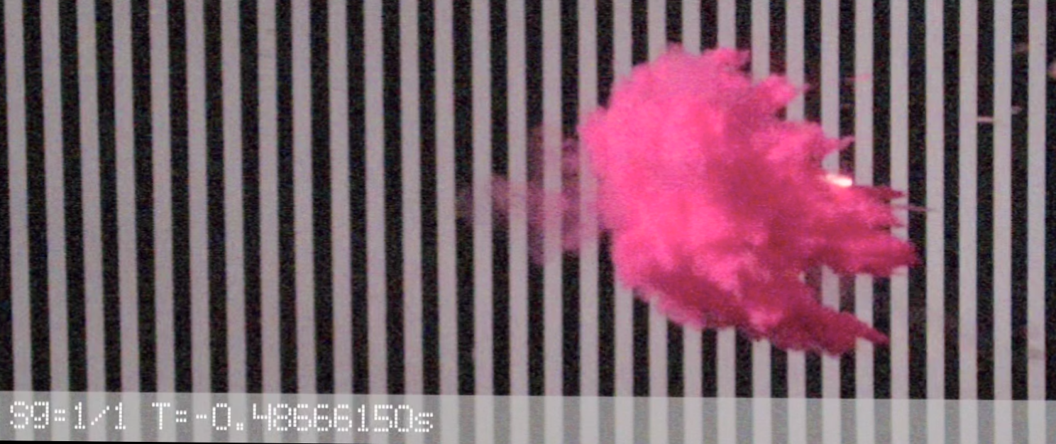

Latest electro-pneumatic with automated velocity control and laser range finder. Air burst system optional. FCU has electronic pressure sensor, firing, round charging and programming based on LRF data.
Image of airburst was a round fired at 400fps 150ft from target.

Not sure why I am having trouble uploading the file but here is a youtube video of the LRF identifying two targets at 25 and 50m and detonating the shells before they impact.
https://youtube.com/shorts/klAuaUM3k-0?feature=share
