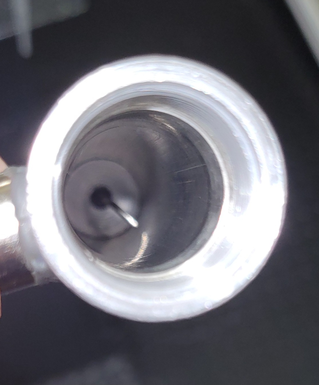

This effect would be affected by the chamber's interior, however. The more bends, rough surfaces, and such, the faster the gases would go turbulet. With that said, VERA has a fair amount of equipment mounted internally and the construction (steel pipe) means a less-than-glass-smooth surface. By contrast, if you're building a gun out of a straight piece of very smooth interior pipe? OK, maybe turbulence doesn't dominate so quickly.
In the case of my testbed it's very smooth, this was also a cylinder in which a piston was moving so it had to be.
Perhaps it's worth adding some basic baffles as an experiment.
