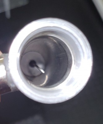

Question: How smooth is the interior of your guns? In the case of VERA we tried a couple different burst pressures and while the pressure ramp to the disk burst was obviously longer for the high pressure burst, the muzzle velocity of the gun was indistinguishable... Which made sense given that in both cases we saw the afore mentioned step function in chamber pressure. The only rational answer was flame propogation rates going to high velocities when things started to actually move. This effect would be affected by the chamber's interior, however. The more bends, rough surfaces, and such, the faster the gases would go turbulet. With that said, VERA has a fair amount of equipment mounted internally and the construction (steel pipe) means a less-than-glass-smooth surface. By contrast, if you're building a gun out of a straight piece of very smooth interior pipe? OK, maybe turbulence doesn't dominate so quickly.jackssmirkingrevenge wrote: ↑Sun Dec 03, 2023 1:11 pmInteresting point and glad you chimed in. Could it be that with VERA the disk burst pressure was always inferior to this seemingly "ideal" pressure for maximum power? It seems clear from my own experience and others that having the disk burst too early results in lower power.D_Hall wrote: ↑Sat Dec 02, 2023 2:53 amLate to the thread here (and I've only read the first post) but one of the things I've seen with VERA is that the burst pressure doesn't really make much difference (at least, not on her). Why? Simple, really... Once the disk bursts and the gases start to move, everything becomes very turbulent. With the rise in turbulence, flame propagation rates go through the roof.
In the case of my testbed it's very smooth, this was also a cylinder in which a piston was moving so it had to be.D_Hall wrote: ↑Wed Dec 06, 2023 12:01 amThis effect would be affected by the chamber's interior, however. The more bends, rough surfaces, and such, the faster the gases would go turbulet. With that said, VERA has a fair amount of equipment mounted internally and the construction (steel pipe) means a less-than-glass-smooth surface. By contrast, if you're building a gun out of a straight piece of very smooth interior pipe? OK, maybe turbulence doesn't dominate so quickly.
Perhaps it's worth adding some basic baffles as an experiment.
