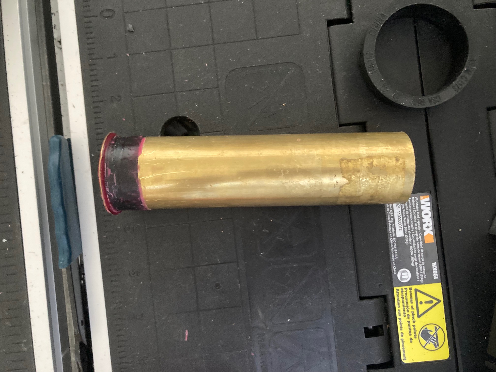

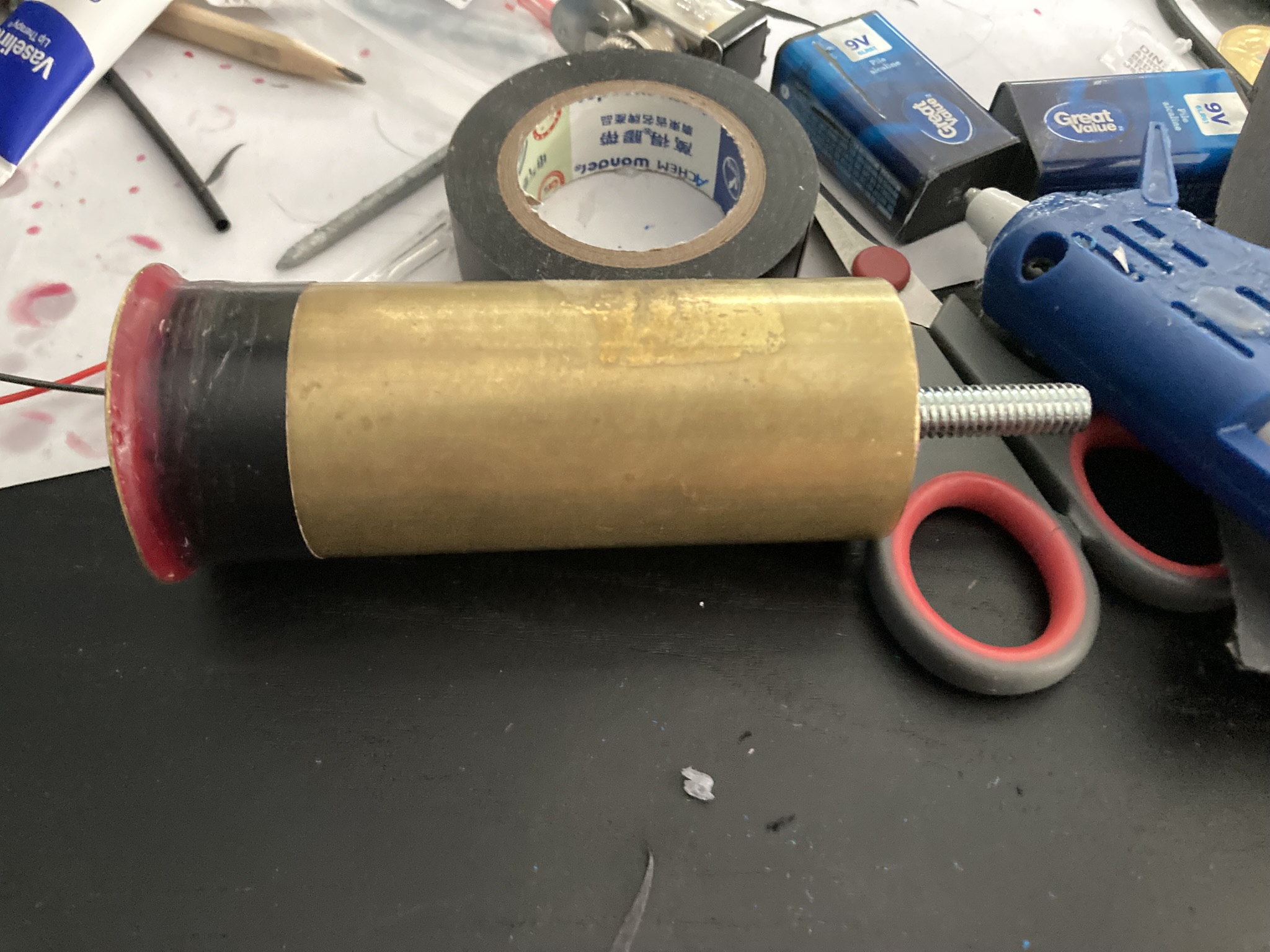

Cannon uses a brass "shell", also known as the 1.5 inch brass fitting I found in the home depot plumbing section, covered the lip area with wax and electrical tape to keep in the pressure so the gas doesn't escape, along with heat shrink on the wires to keep it from fraying, 2 points of ignition for more power, and of course, the "bolt" of it, the floating barrel just simply sitting there with Vaseline applied to keep it's movement smooth, handle and the layering I've added onto it required me to apply heat and bending it to shape, thankfully had a p100 mask my dad gave me beforehand incase of fumes, even when I did it outside

Wires wrapped around 8-32 machine screws

Brass shell

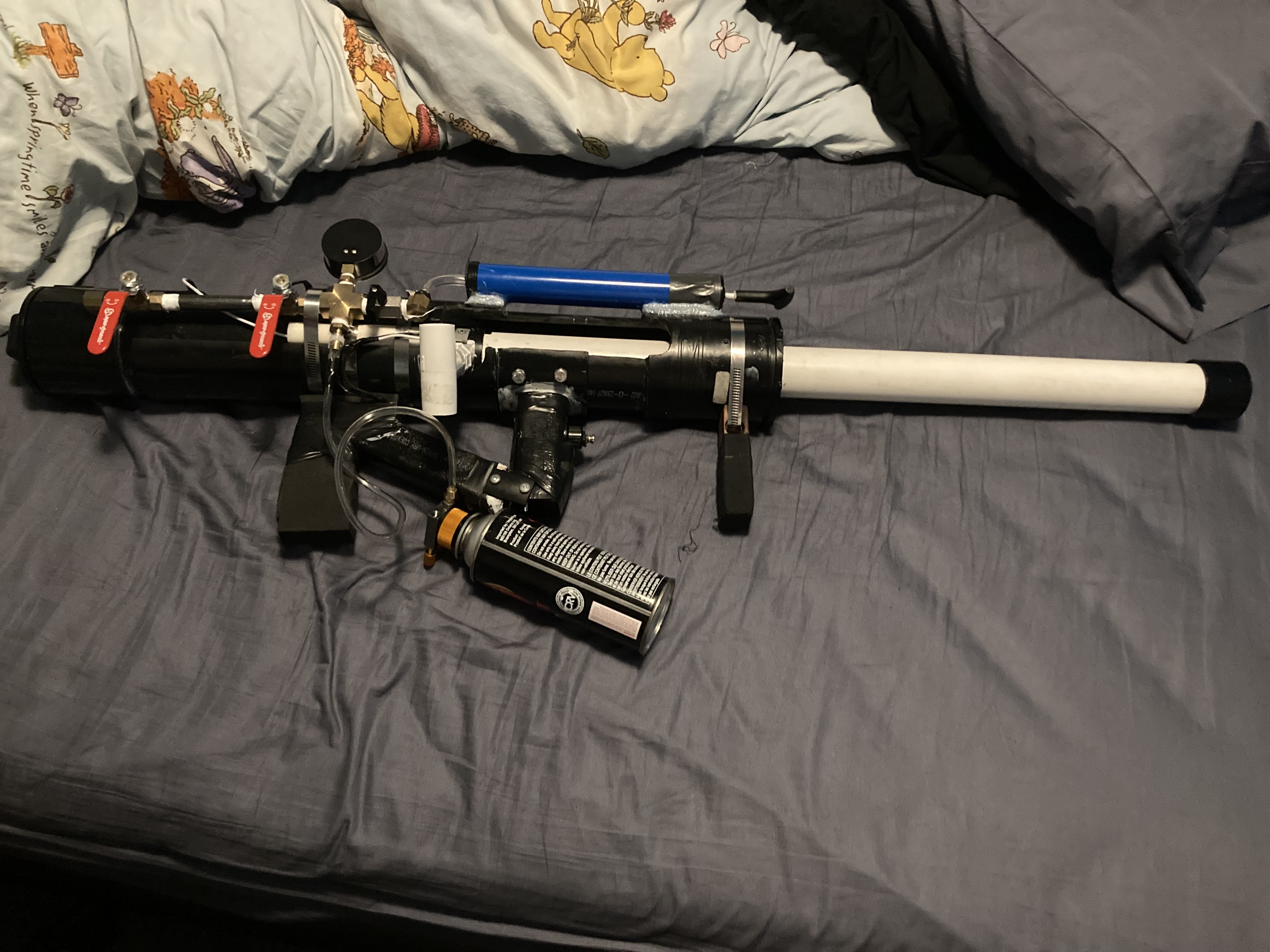

Regardless, the current cannons design,
New stuff: gas metering and injection, the thing is a fairly small but it works well regardless at 20-40 psi worth of butane, found just 1-2 injections makes pretty good launches, crude as hell 'thumb hole grip' that's literally being held by a hose clamp with a L bracket screwed to the grip under the clamp, new trigger that replaces the old big red button one for a 1.5v bbq igniter that automatically sparks when pressed (something I salvaged from my schools auto shop scrap yard from a grill :) ), and a air pump, purpose of it is to get air inside incase of a misfire because of a lack of oxygen, had to drill out the nozzle of it to make room for the vinyl tubing
Few more stuff is new electros, went from 8-32 machine screws to 10-24 ones, new 18 gauge wires taken from a broken washroom mirror light, extra cut coupling solvent welded onto it to make it more sturdy, and make it... look less flimsy, no fan as of it yet, because I done goofed up and shorted it by getting too curious with batteries, lets just say; don't directly shoot 16 volts into a 12 volt computer fan with a drill battery :lol:
Had on it on my bed since I had to get my hot glue gun to attach the air pump onto the cannon, hot glue gun being in my room and couldn't be bother to bring it to my garage (not like there would a nearby outlet anyway lol)

Thanks for the comments! The cannon performed nicely when I went out back to shoot a large paper cone type of dart and 3 cut russet potatoes, found the optimal mix is filling the cannon 3 times or 30 psi of butane, air pump worked as expected and 'troubleshooted' the misfires :)

As it turns out it goes at 320-ish feet per second or 97 meters per second, still pretty solid for a second build, especially when I load it with a dart round or regular spuds still mauling a rotting tree stump
However for the incomplete combustion issue, I could just add an extra 6 inches of barrel, going from 28 inches to 34 inches, which would bring it to 350-ish feet per second or 106 meters per second, won't be doing that for a while since my school project (being this potato cannon) is coming pretty soon after winter break and will be presenting it to my classmates, and already blew crap loads of money on a hho generator project in school too, at least I know mc master carr and metal places around my area are pretty good... :D
