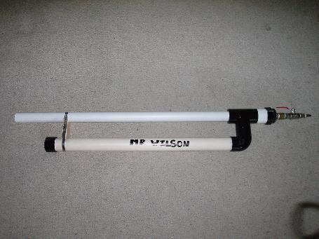

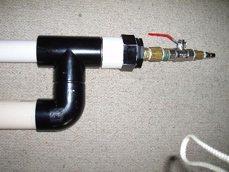

This is a rebuild of my old gun which was very....Well touchy hit and miss with firing well.

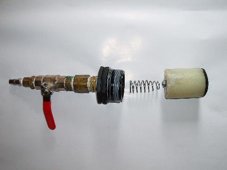

Its sports a barrel sealing piston valve in a 50mm T and with 40mm porting the piston is made from melted hot glue sticks poured into a piece of 50mm pipe for the correct size and shape.There are two linear groves cut into the piston to allow filling of the chamber.
This has only been fired at 60psi as its very loud as is and in the urban area in which i live i might have a SWAT team or something onto me.I am however going to a mates place next week were there can be as much shooting as i can do.Thats were the damage pics will come from.
Well here's Mr Wilson,Enjoy!

Mr.Wilson in all his glory.
What a unit of a gun.
The whole assembly
The whole assembly

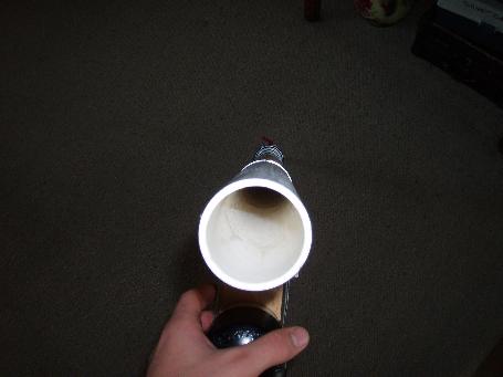

Looking down the barrel.Sorry about the dull picture.

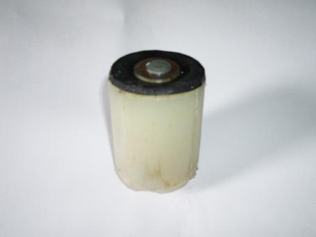

My piston all lubed up.

Nice, I take it hot glue works good for pistons. Why did I not think of that?

nice simple piston gun. i would be careful with the hot glue piston though, i know that hot glue can melt in sunlight. i wouldnt leave the gun outside for too long.

I didn't think of that,but i try and not leaves my guns in sunlight anyways as it weakens the PVC polymer.

You DOnt need that Spring un less urs is special it should seal agains the barrel with the pilet air pressure and without the spring it will release faster which will make it go further

Ohhh. I like it. Im starting to really like piston valves. This is a good mid sized gun and looks like fun to shoot. The piston however looks a little heavy and this may hinder the performance of it. Maybe if you hollowed out a part of it and made it a little lighter you could get better acuation.

I have the spring to act as a sort over bumper to reduced the force of the pisotn moving backwards.I'm happy with the way it fires now but i might remake another piston thats lighter.

Nice gun man. I love the idea on the piston, with the glue sticks. How many sticks went in there ? Isn't your piston to heavy ? Does it slide easily in the pilot chamber ?
