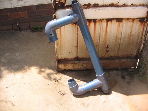

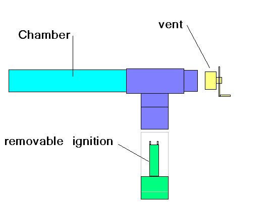

I am planning to make my first combustion, I want it to be good. I have an pressure rated scrapped air chamber that I want to use for my combustion.
I am planning on getting a stungun or a camera flash ignition, most likely a camera flash. The ignition will be removable so I can use it for future cannons or for easy maintanance. The back of the camber will have a tee, the ignition will go at the bottom of the tee and the vent, with a chamber fan will go at the back of the tee. The chamber is 75mm wide, about 3 inches, I want to now the best chamber legth and best barrel size and length.

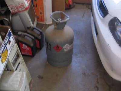

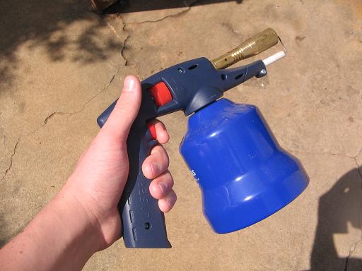

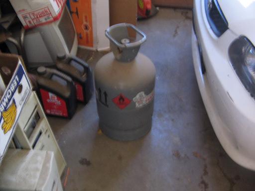

I am thinking about propane injection, as I have a huge tank of propane to use at my dispence. How do you rig one of those small propane tanks up to your propane metering system? I use them in my blow tourch but what fitting do I use to link it?

- the chamber as planned.
- plans1.JPG (13.66 KiB) Viewed 4866 times

Well there isnt a rule on what is the best pipe sizes to use,more so it is the ratios used on the combustion cannon.The opitmal ratio is rumord to be a .8:1 C:B ratio.
As for the propane injection.You do no the basics of propane injection?Dont you..Good so we can skip that part...For that propane tank is there a pressure reducer?A little disk shaped object,this lowers the pressure considerably and unless you want a metering system that is 1/4 the volume of your chamber then dont bother.
No doubt you have seen 1/4 NPT hose barb conectors.A simple way is to just cut the hose for you propane bottle(make sure its not turned on)and add the hose barb along with a hose clamp.Now you have NPT for your propane bottle and the rest is easy as the leg bone is connected to the knee bone the knee bones connected to the thigh bone etc..etc..

I will do some more research on Burtnlatke about ratios. As for the propane injection, you mean I need a regulator for the big tank? I thought propane was always 90psi. I am not to sure what you are trying to tell me there.
"No doubt you have seen 1/4 NPT hose barb conectors.A simple way is to just cut the hose for you propane bottle(make sure its not turned on)and add the hose barb along with a hose clamp.Now you have NPT for your propane bottle and the rest is easy as the leg bone is connected to the knee bone the knee bones connected to the thigh bone etc..etc.. ", ???, is this for the small tank?

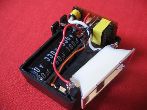

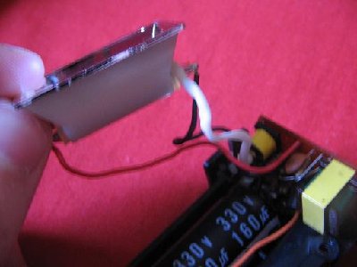

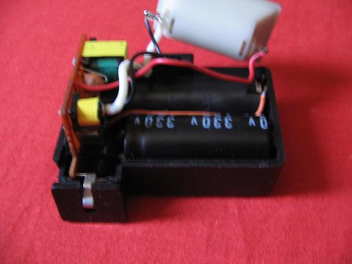

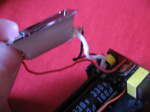

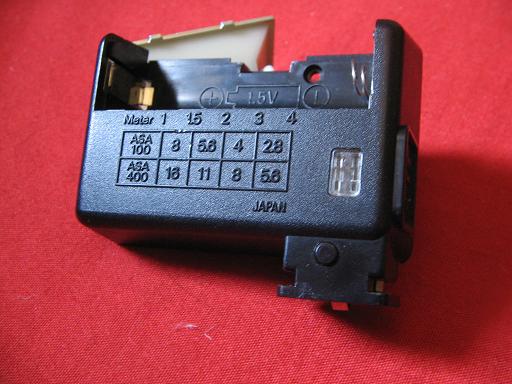

For the camera flash ignition, I am sure I have found the perfect flash, it is not from a disposable camera, it is an actual camera flash. I could make it reliable if I make a good job out of it. Look at the pics.
On the flash there is a red, black and thick white wire, whats the white one for?

I meant by the regulator that is usualy attached to them that reduces the pressure to like 7psi or something small like that.And i meant that for the propane injection for the metering system.Got MSN or something much easyer to explaine.
Nope, no Msn, sorry. Why do you need a regulator? On BurntLatke the propane metering systems are 90 psi, arn't they. Look here, you will see what I mean: http://www.burntlatke.com/jpg600/lp-test.jpg

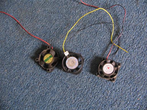

I found my chamber fans and we have a big rechargable battery which is 12 volts, PERFECT! It is mean't for one of those tourches but it is spare. We also have a tourch which is not working so I can take the charging circuit out of there and use it for my chamber fans. This combustion is going to be impressive 8)

Take the red and black wires and connect one to a screw and one to another screw that are screwed into your chamber. Have the screw tip be about 4mm apart in your chamber, push the button, and a spark should jump between the screw tips makeing the cannon fire. You should probly look up this kind of ignition on the spud wiki, mite be easier to understand.
I know how it works, I was just wondering about the white wire. So from what I understand it serves no purpose in my design what so ever. I think I will test the ignition soon. Thanks jrrdw.

Camera "stun guns", as I've seen them, don't create spark gaps. They use two contacts and when flesh contacts them, the charge is sent through the target.
For a spark gap that can jump more than .001", you need another way to rig the camera. For this, you need three wires, not two, as in standard ignition.
Two go to the ends of the flash tube, and these carry the +/- charge. A third goes the metal plate behind the tube. This one carries a strong + charge.
All three ends of the wire need to be connected to where they rest about less than a mm apart.
Then, charge the camera, and fire. Even before you press the trigger button, all the current is applied to the flash tube ends. If you touched them, you'd be fried. The wire from the metal plate ionizes the air between the end electrodes, and allows the current to flow when the button is pressed.
Believe me, I've experimented with this before. Never actually used it on a gun, (because it's a PITA to try and figure out how to wire dual gaps), but it's ultra-powerful and'll work great with your average hair-spray gun for igniting far-from-stoichiometric fuel/air mixes.
Ok, so that explains why I didn't get a spark when I tried to. So I will have to get a stungun, no problem, Christmas is coming
Camera flash has been done befor though, let me do some more research of wiki. After all, I did just cut the bulb and reflector out of my moms flash without asking.
I charged the capacitor in the flash and I don't think it is discharged yet, is that a bad thing? I do not want to get shocked.
