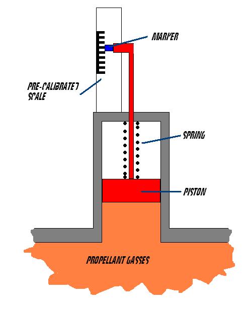

How about a spring-loaded piston attached to some sort of marker that hits a graduated scale (that would be easy to calibrate with known pressures of compressed air) to record peak pressure?
- peakpressuregauge.JPG (23.65 KiB) Viewed 4499 times

jackssmirkingrevenge: That is exactly how the cheapo tire pressure gauges work. (well, there are a few minor changes, tha scale itself moves instead of being stationary...)
The piston is a rubber cup that also seals the cylinder. There is a return spring. The marker (scale) is not attached to the piston so when the pressure drops and the spring forces the piston back to its starting position the scale stays at the maximum reading. (see http://auto.howstuffworks.com/pressure-gauge3.htm.)
It is a very simple design, and cheap to make. You can pick one up at Kmart for $2 or less. Many have a 50 PSIG upper limit. If you hunt around a bit you can usually find ones that max out at 100 or 120 PSIG.
