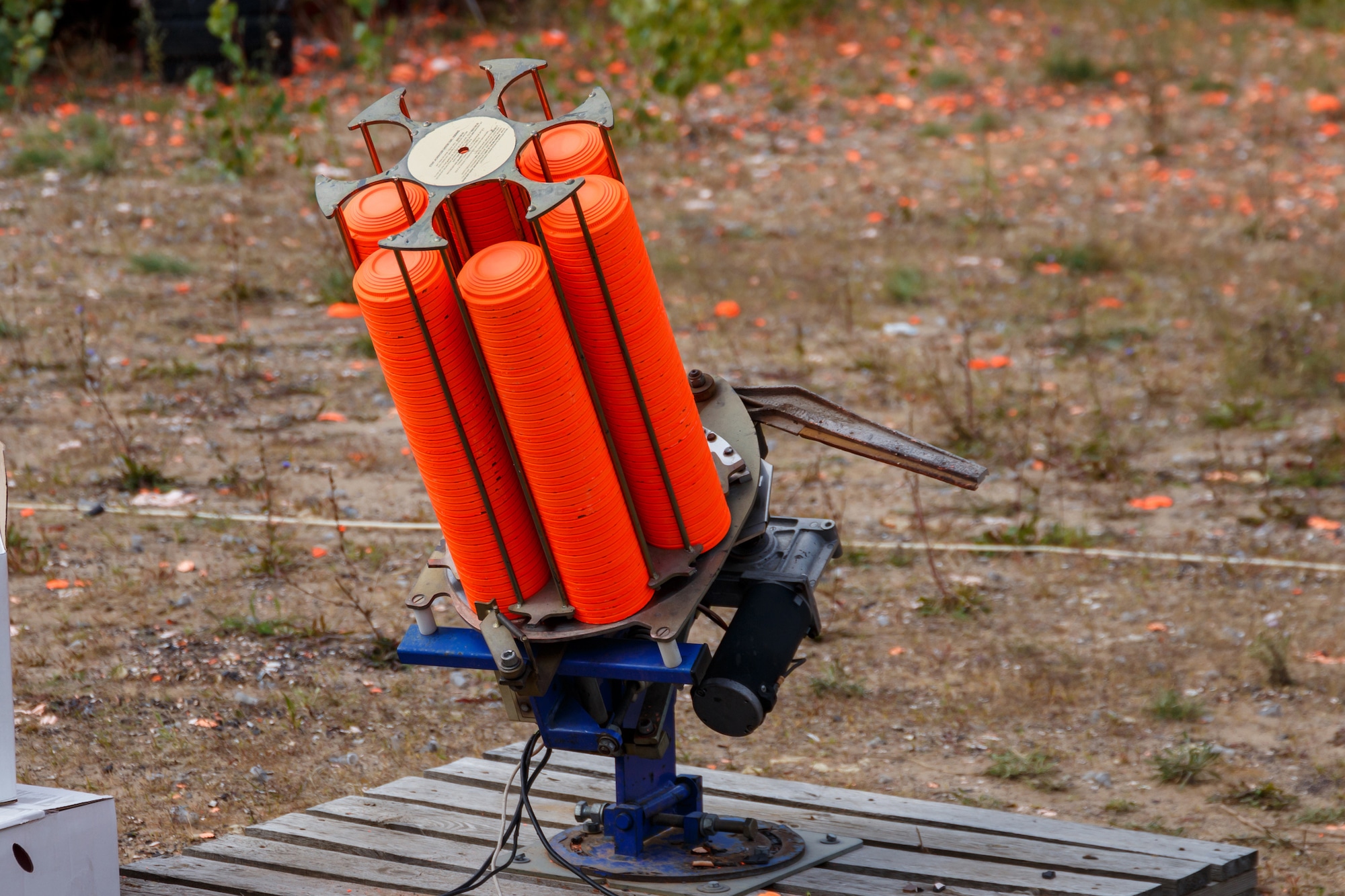

A skeet launcher comes to mind
This might be worth a look
