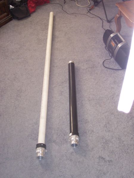

Here is my newest incarnation of spudding mayhem. Used my same formula of 4" x 24" ABS down to a 2" fitting. I got an aluminum camlock deal for the interchangable barrels, and the aluminum were cheaper than the poly cam locks.
The ignition is a 12k volt 1.5VDC powered BBQ ignitor that has two pair of contacts going to the two spark gaps. A threaded steel schrader valve for the propane injection right in front of the 80MM chamber fan. The Valve in the back is a 1" Ball Valve that attaches to a close gap steel nipple that comes in from the other side of the cap.
The handles are 4" caribeaners from Harbor Frieght.

Unfortunatley with those cam locks the ID is smaller than the 2"ID spud barrel so you can't breech load a spud. The PVC GB Barrel is bolted on and the bolts act as a rollback stop but it is removed after each shot so that I can blow the chamber out quicker and the barrel can be reloaded easier since it's almost 7' long.....oh and that ignitor I got really lucky on getting. My neighbor had a BBQ with the battery powered ignitor on it (that one actually) and his wife was trying to cook on it and ended up burning down the whole thing, the only thing that survived was the ignitor box. Unfortunatley I haven't been able to find them in the stores but if you can find one, never let it go!!!! or try and get one on the charbroil or weber websites.
