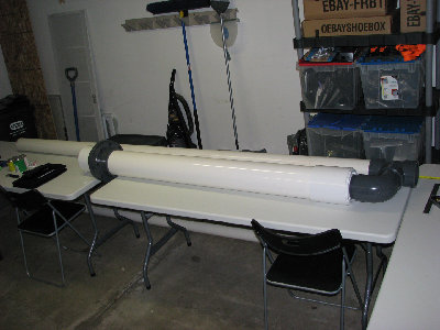

So here's my pseudo build-log for those who were interested in my upcoming cannon. I chose the name CF, because the chamber has just over 1CF of volume, thought it was fitting. Please note, the tee/elbow and the flange assembly are dry-fitted and have not yet been glued. I barely had enough energy to pose the cannon for pictures let alone prep and glue those fittings.
Basic information
- The chamber is 6" ID, 60" long excluding the fittings.
- The barrel is 4" ID, 120" long excluding the tee/breech.
- The cannon weighs about 70lbs right now, it will weigh about 130lb when complete (stand, electronics, and breech block). No, I never wanted this to be hand-held.
- The propane meter will be approx. 22" of 3/4" piping, but I will calculate the total volume with the fittings before making this official.
- The cannon will feature a vertical sliding-wedge breech block for quick reloading of large ammunition. This is really the main reason I started this project -- the rest is just cake.
So yeah, it's a big gun, there's larger but this is respectable. Whatcha think so far? I have not shown any of the electronics yet, I haven't fully gathered what I need yet.

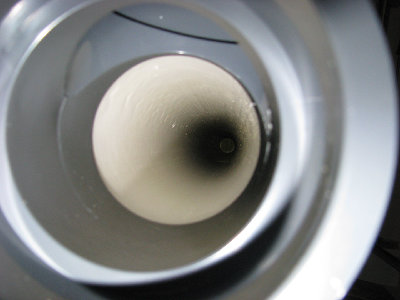

- The end of the chamber. So far, using flanges is the most economical method I've found to plug up the end of the chamber. Since it's 6" ID, I plan on making a nice sliding spark strip that can be easily serviced without jamming my arm down the chamber. I have lots of room, might as well take advantage of it!

Nice size bud. She'l be pretty sweet when done. WHat are you using to power the spark strip?

You have a perfect set up for a piston valve!
Ahh so there it is. I didn't really grasp the scale of the thing until I realized those were standard 6' foldout tables underneath..
So a breech loader...don't forget to calc the elbow volume into the tank size.
What have you decided on for ammo?

Applesauce jars.starman wrote:Ahh so there it is. I didn't really grasp the scale of the thing until I realized those were standard 6' foldout tables underneath..
I have also made some ammunition out of 3" PVC scraps. Along with my breech, I am designing an extractor that'll pull casings out of the breech when opened. Just like the real thing, though I may have to make it lever-operated instead of automatic, but that's fine.
