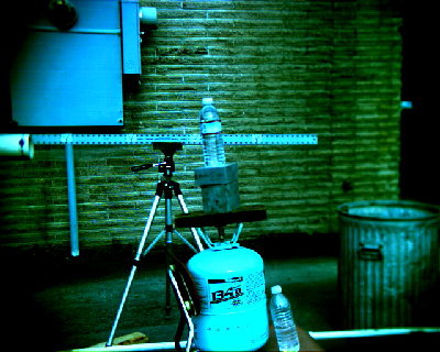

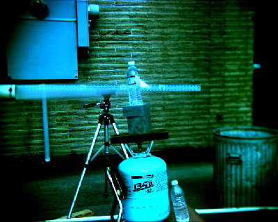

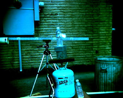

Good explanation. I think I have some photos to support that taken with a high speed video camera at 1,000 frames/second. Sorry the color is off. The borrowed camera was set for indoor and we shot outside. I brightened it up some with The Gimp.covey12 wrote:sound is not supersonic, for a supersonic crack you have to go more than 1250fps which is the speed of sound, or sound barrier, when the sound barrier is broken, it makes a loud crack, since you have no ammo, there is no visible shockwave like you see when f-16s go supersonic, i hope that helpedinonickname wrote:Of course it's a supersonic crack..most soundwaves are supersonic.
What was the ammo? May be able to shed some more light. I doubt a 1x will push supersonic.
Remember, each frame is only 0.001 seconds apart. How fast is the flow? This is an air cannon. Yes, it was loud.
Specs,
700 cubic inch chamber
~80 PSI
2 inch quick dump valve
2.5 inch barrel, 7 feet long.
Broken apple in barrel provides the applesauce mist.
Video speed 1,000 frames/sec.
metal measure in photo is 5 feet long with each foot marked in masking tape and magic marker.
Just how fast is that applesause traveling?
The apple shows up Time +3 and initial impact is in frame +4.
This video was shot to confirm the valve speed. Full flow in under 2 ms.
The Freon tank the water bottle is sitting on was made into the winning t shirt launcher.
Last edited by Technician1002 on Mon Apr 27, 2009 6:05 pm, edited 1 time in total.
