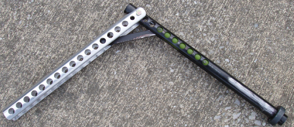

here are pics of the pump.

What is the range of motion of the piston inside the pump in terms of inches during one cycle?

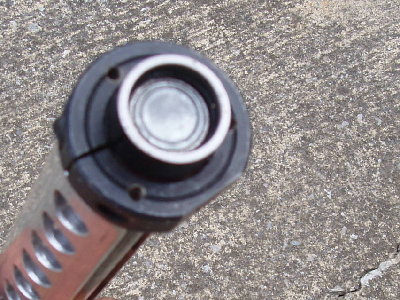

Is there any way you could show us the piston outside of the cylinder?
How many cycles does it take to attain say, 300 psi? Probably not too many considering the small chamber volume.
Thanks again.
Thanks again.

I don't intend to be harsh, but reading a little more closely might be to your advantage. Two of those questions were answered in the opening post...
Question:
Question:
Answer:King_TaTer wrote:What is the range of motion of the piston inside the pump in terms of inches during one cycle?
Question:wngovr wrote:... now the 3/4" piston has a 6" throw.
Answer:King_TaTer wrote:How many cycles does it take to attain say, 300 psi? Probably not too many considering the small chamber volume.
wngovr wrote:... so pumping up to 300 lbs. is a breeze. About 35 to 40 pumps.

I don't want to take the piston assembly out because i put super glue on the pins to keep them from working their way out and scoring the cylinder walls. I drew this picture to try and show you whats inside. The piston had a piston arm attached to it so I drilled a hole in the end of a nylon rod big enough to allow the piston rod, then drilled another hole to put a pin through the piston rod. There is a little space between the piston and nylon rod to allow the piston to move freely just a little separate from the nylon rod.
