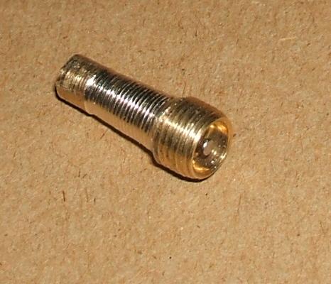

Has thanked: 581 times
Thu Oct 22, 2009 1:14 pm
Construction in progress, figured I'd improve my chances by slimming down the schrader a little :)
edit: cartridge is curing, I canted the schrader slightly as Copperboy suggested above. We'll see how it works tomorrow.
the bits before epoxy treatment.  It took me a remarkably small amount of time to put this together, if it works they should be easy to manufacture in quantity.
