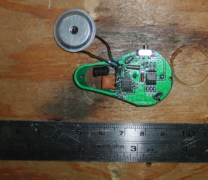

Some views of the beeper circuit, and the vague idea in my head of what to do with it. Range is about ten metres, even through a solid wall. Still, any ideas on extending the aerial (which is integrated in the circuit board)?
I wonder if orienting the beeper that way would damage it...

uhmm I don't get it is it just a beeper or does it use RF? If all you want is sound then you might as well buy a buzzer for like 2$ or so... since you're not limited as much as mrcrowley as far as diam. is concerned then you might as well get a really powerful one (>110db or so)some views of the beeper circuit
- Has thanked: 581 times
Ah, but this one only beeps when you tell it touhmm I don't get it is it just a beeper or does it use RF? If all you want is sound then you might as well buy a buzzer for like 2$ or so... since you're not limited as much as mrcrowley as far as diam. is concerned then you might as well get a really powerful one (>110db or so)
All over your garden, in small piecesPetitlu wrote:And tungsten, where it is?
I attached a short length of wire to it and the range improved considerably...

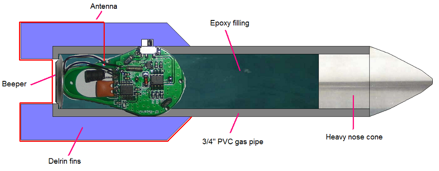

Here's a keep-it-simple idea, the only disadvantage is that you can't change the battery...
I can make the above with relative ease, and I have four beeper units.
We could do it in stages, first shot running it as a basic burst disk pneumatic, if that works progressively higher mixes
