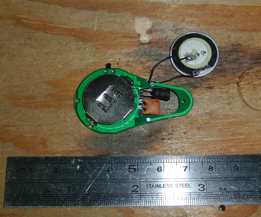

Some views of the beeper circuit, and the vague idea in my head of what to do with it. Range is about ten metres, even through a solid wall. Still, any ideas on extending the aerial (which is integrated in the circuit board)?

uhmm I don't get it is it just a beeper or does it use RF? If all you want is sound then you might as well buy a buzzer for like 2$ or so... since you're not limited as much as mrcrowley as far as diam. is concerned then you might as well get a really powerful one (>110db or so)some views of the beeper circuit

Ah, but this one only beeps when you tell it touhmm I don't get it is it just a beeper or does it use RF? If all you want is sound then you might as well buy a buzzer for like 2$ or so... since you're not limited as much as mrcrowley as far as diam. is concerned then you might as well get a really powerful one (>110db or so)

I attached a short length of wire to it and the range improved considerably...
Here's a keep-it-simple idea, the only disadvantage is that you can't change the battery...

I can make the above with relative ease, and I have four beeper units.
