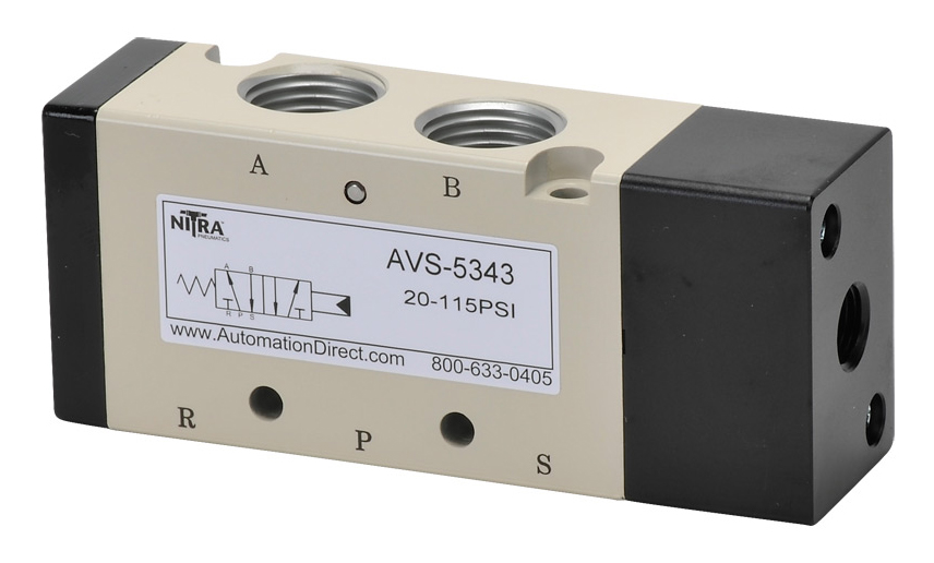

Wed Jun 29, 2016 3:42 pm
Just using off the shelf pilot air valves, I have a 3/8 port for the barrel and a 1/8 port for the pilot.

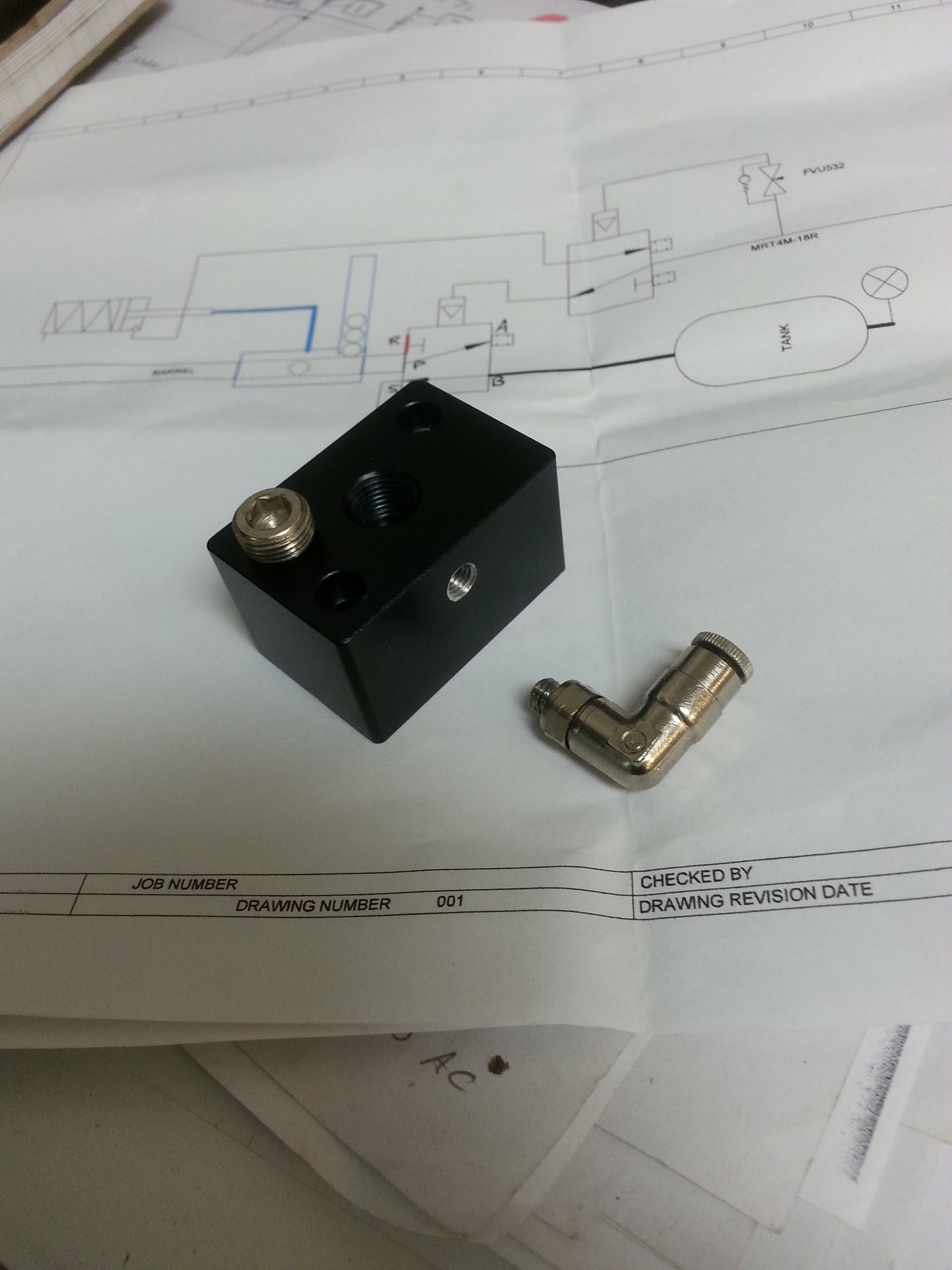

Thu Jun 30, 2016 3:30 pm
I might fabricate it from stainless sheet if I need to get the volume, have Tig welder as well, or use tubing, haven't got that far yet.
Converted my main valve pilot to side entry pilot, found a nice 1/8' flush plug to fill the original hole, new hole is M5
Kensingt0n
Posts: 19
Joined: Thu Oct 29, 2015 6:02 am
Thu Jun 30, 2016 5:55 pm
Damn man, that's a mad idea for your pilot valve.
