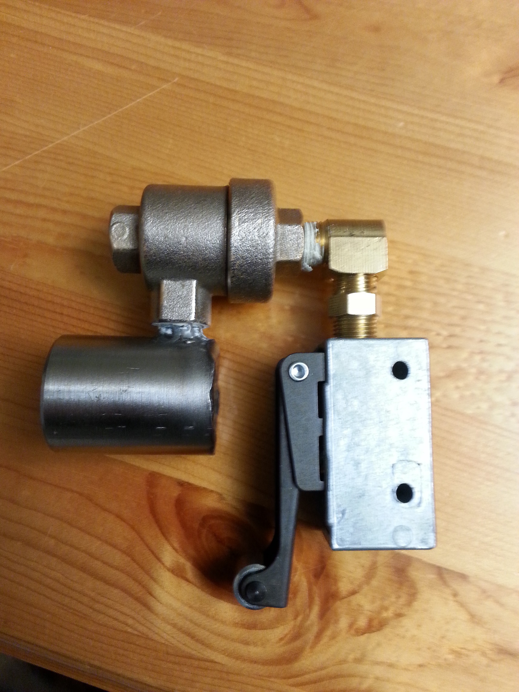

Playing with some bits I had, 1/8" QEV, trigger valve and 1/2" NPT coupler capped one end and 1/8" male thread welded to it to connect to QEV. 1/2" coupler is to screw in chamber.
Maybe like this :idea:

That looks great F1...what are your plans for it, caliber, semi-auto, power, etc?
farcticox1
Canada
Posts: 1085
Has thanked: 69 times
Been thanked: 100 times
Fri Dec 08, 2017 5:33 am
I have a piece of 6.5mm ID tubing and some 1/4" steel BBs. :idea: It will just be single shot and muzzle loading :shock:

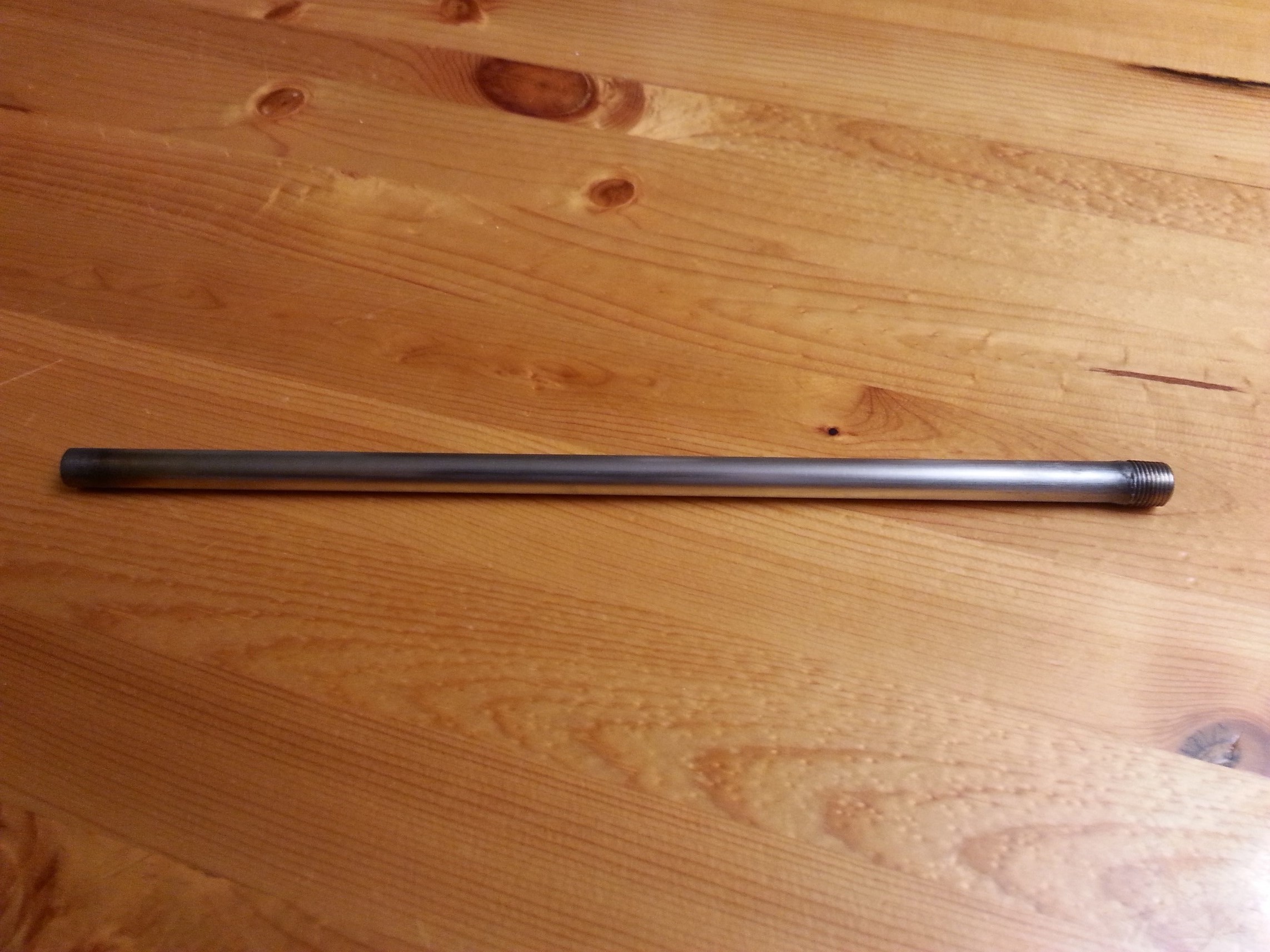

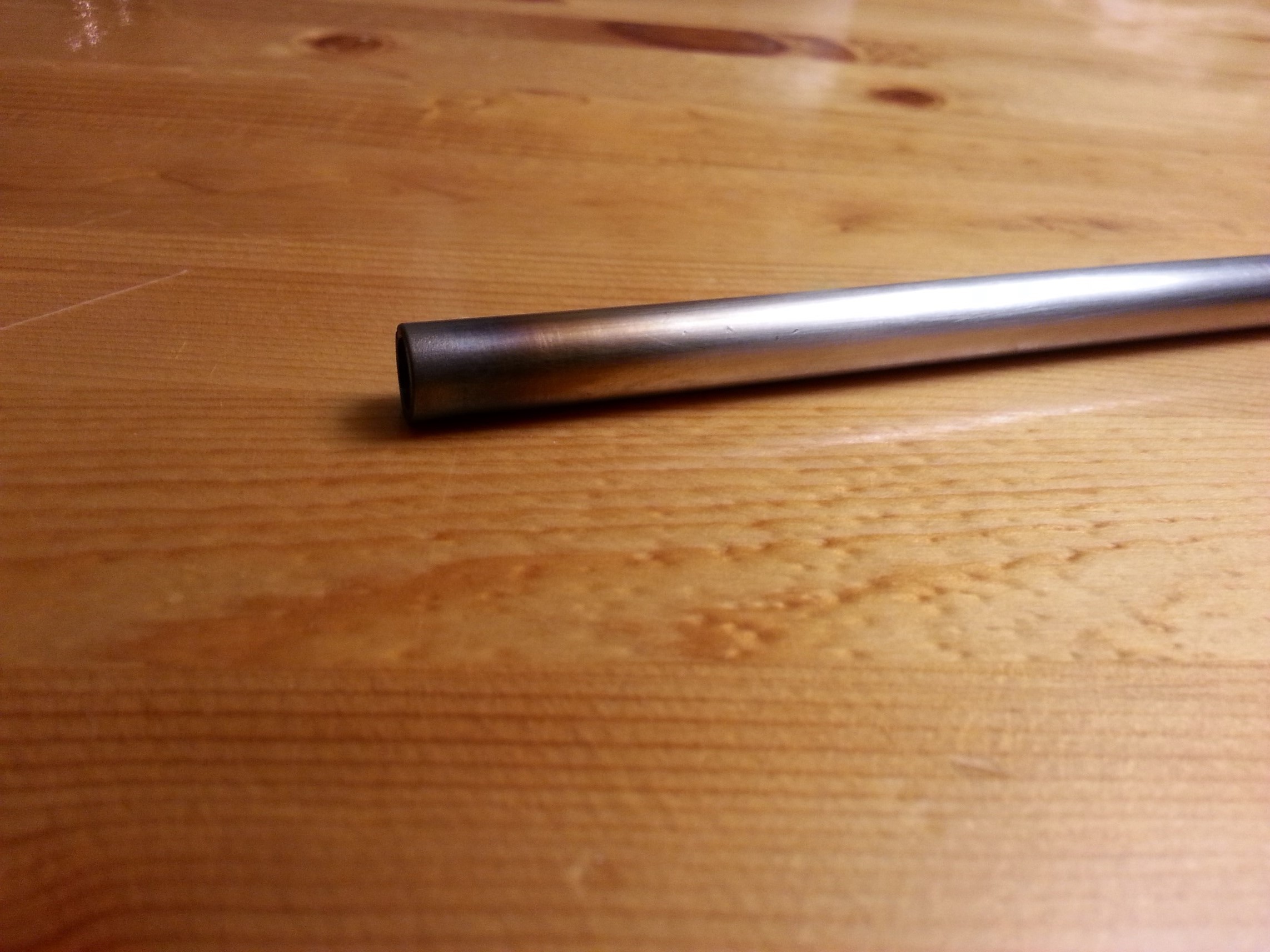

Managed to Tig weld a piece of 1/8" thread to the barrel without destroying it :shock: It's somewhat straight but I won't be using it in the Olympics so I think it will work.
Blued the end :idea:
