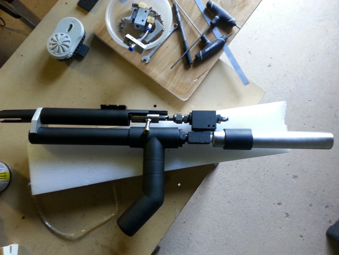

Hello, after playing a bit with my primitive QEV & slide valve rifle I wanted to build something nicer. I browsed a bit for ideas, read about those nice trigger 3 way 2 position valves, ordered one, it arrived. Inspiration has been this project: http://www.spudfiles.com/pneumatic-cann ... 26765.html
First of all, one hole is off centre, spoke with the seller and he says it is actually so, and in another listing which had pictures of the holes it was actually off centre as a new design. I guess this will be the port completely open to the atmosphere. Second picture here, mentioned in another thread, bought the same one:
https://www.ebay.com.au/itm/Mechanical- ... 2138858584?
epid=1255627187&hash=item2814468858:g:J6MAAOSwCGVX9I-X
Currently by my super scientific method of blowing into it, I can tell that A and R communicate while P is closed, when the trigger is pressed P communicates with A. As I don't want to drill small holes into my QEV, should the connection be QEV P (pilot?) port --- JM-07 P (pilot) port?
Then A port on the QEV will be the secondary chamber housing shot air, while the primary chamber and filling port will be between the P ports of the QEV and JM-07, while the A port is plugged off by an adjustable chamber (as seen in a video here: http://www.spudfiles.com/pneumatic-cann ... 26793.html , though he has perforated his QEV) to find which volume suits me best?
Plenty of questions actually :D

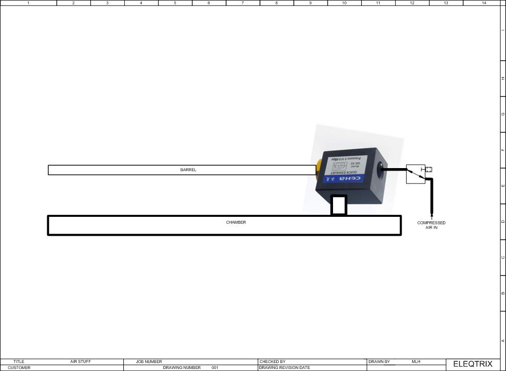

farcticox1
Canada
Posts: 1085
Has thanked: 69 times
Been thanked: 100 times
Tue Jul 24, 2018 5:35 pm
If you don't modify the QEV I think this should work.
Now I realise the sealed exhaust wouldn't work as it doesn't vent to atmosphere after firing. :shock:

Wed Jul 25, 2018 6:03 pm
That's a good layout for a single shot as it will dump the whole chamber , that's how I did mine.

Thank you but you got me even more confused :D Perhaps I have grasped the concept of your second post below, ditching the adjustable exhaust volume, which I don't comprehend anyway, as I cannot explain power and exhaust volume correlation, ie low volume - more power
From what I understand I got a normally closed valve, so making this http://www.spudfiles.com/pneumatic-cann ... 26765.html is viable or do I have to keep the trigger pressed and it works when released? Will be trying fitting my JM 07 https://www.ebay.com/itm/JM-07-1-4BSP-T ... Desc=0%7C0
JM-07 R port to QEV P, JM-07 P port to air chamber, looking at regulated paintball tanks which I call fill witha pcp pump as it had been suggested. Of course QEV A port is the shot chamber. In the earlier post I am probably wrong to connect QEV P to JM-07 P as the air chamber won't be shut off. Considering that the total cost will exceed hobby money(over 140$) I want to get everything right before ordering the expensive parts.
Would I by getting this https://www.ebay.ca/itm/Air-Pneumatic-2 ... 100623.m-1
connecting QEV to A, air chamber to R and P left to the atmosphere, I would be able to have multiple shot without any QEV perforation?
EDIT it seems that my inspirated was in turn inspired by these posts http://www.spudfiles.com/spud-cannon-re ... lit=roller
I've got to get the 2 position 3 way valve function down.

The adjustable exhaust will give you adjustable power for each shot, without it the whole chamber will pretty much empty each time. But only if you fill through A and modify the QEV if your using a 3/2 trigger, which I believe you already have.
What do you want to build exactly ? What parts do you already have and want to use ? do a drawing and maybe start a seperate post :idea:
Sat Jul 28, 2018 6:47 pm
KnooBill wrote:Currently by my super scientific method of blowing into it
Hey, it works ;)
If A is the common port, then it should be attached to the QEV pilot port.
If A communicates with R when the valve is at rest, then R should connect to your main chamber, while P should be left open.
an adjustable chambeto find which volume suits me best?
Easier to use GGDT to determine what size of chamber will give you the performance you're after.

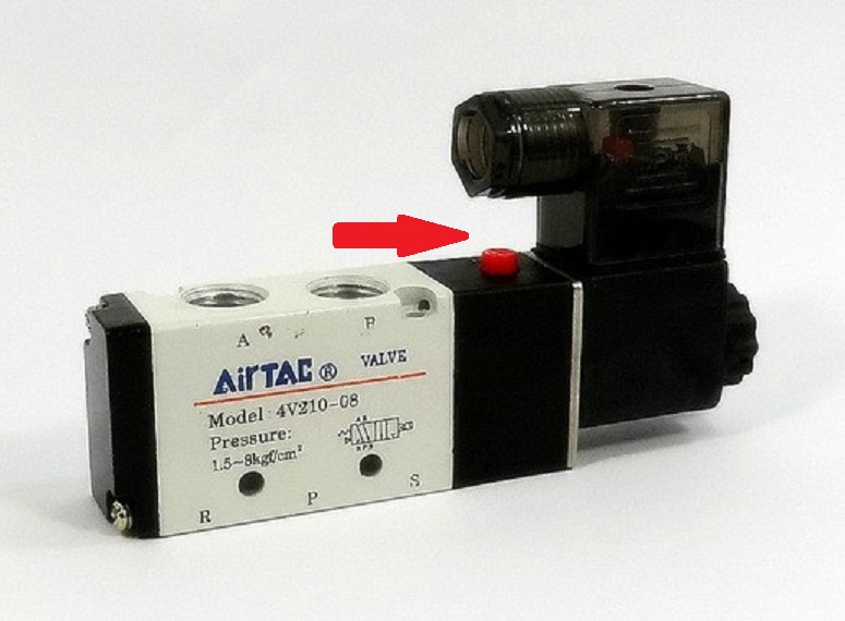

Does anyone know what this red knob is for?
Fri Aug 03, 2018 12:06 pm
Argentina
Posts: 1064
Location: Argentina
Has thanked: 274 times
Been thanked: 276 times
Fri Aug 03, 2018 2:12 pm
:) Solved!
