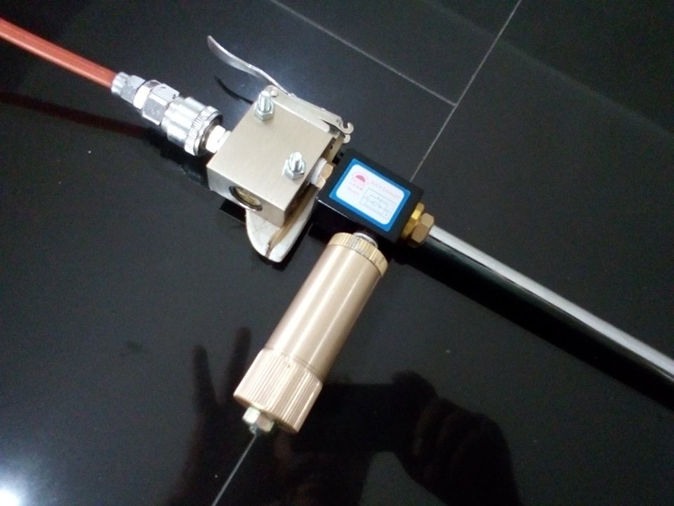

Best valve to fire the QEV and give a decent trigger feel. 1 first valve (2way 3port) was manual and difficult to get a crisp, fast release without jerking the rifle. (See mark 1 photo). So moved on to AirTac 12volt solenoid release - excellent.

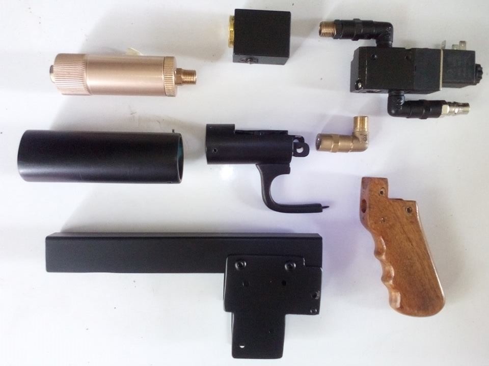

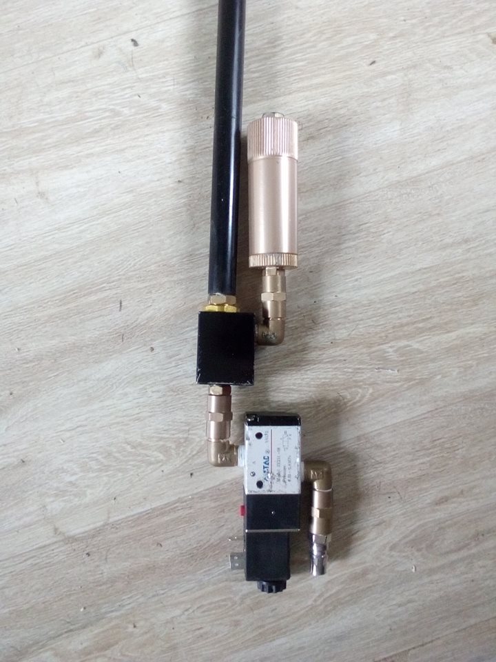

Ok - Current spec as follows:
QEV - Cheap Chinese job 1/4" fittings barrel 3/8"
Air Chamber - alloy moisture trap for pcp hand pump 1/8" thread but drilled out hole. Can easily put in candle wax to reduce volume. (Changing to smaller barrel should mean I can reduce the chamber volume to get more shots).
Barrels - 8mm and 6.5mm with threaded fittings fastened with epoxy. Length 60mm and covered with plastic electric conduit.
AirTac - 2 position 3port 12volt solenoid - with body turned through 180degrees to convert from NC to NO.
3000 MaH nicad rechargeable battery
Trigger Switch - 12volt push button
Air tank - .5 litre airsoft style tank and regulator - rated up to 2,500 psi.
Pistol Grip - piece of hardwood, shaped and laquered
Telescopic sight - Bushnell 3 to 9 X 40.
Rifle action frame (for QEV and Solenoid etc) Scrap metal from roof building!
Silencer - plastic plumbing scrap with cotton wool packing - untested as yet but rifle has a real muzzle bark at the moment!
Various copper fittings and adaptors - see photos.
Air sources - 2,400psi capability stirrup type pcp hand pump.
Small 120psi compressor.

Photos -
1st one shows the original solenoid with a rubber band to hold it Normally open.
Last photo is the nearly completed tool but without the battery fitted - slides into the rear of the frame above the regul;ator. Also I have a cover and butt stock for the air bottle.

Sorry just noticed a typo!!!! I converted the Airtac Solenoid from NC (normally closed) to NO (normally open) by dis-assemblingthe unit and turning the body round by 180 degrees - not turn the piston or end caps etc round. NO keeps the QEV pressurised then and fires via the solenoid which releases the pressure when triggered.
snyper
Posts: 5
Joined: Tue Oct 23, 2018 10:47 pm
Wed Oct 24, 2018 8:24 am
Sorry - noticed a typo!!!!!!!!! Airtac Solenoid comes supplied as NC (normally closed) - you need to swing just the solenoid through 180 degrees to convert to NO (normally open) so it fires the QEV when triggered.

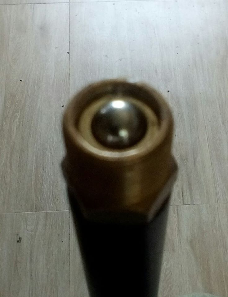

Had a great result yesterday - some Neodymium magnets turned up from China - 9 weeks delivery!!!!! 12mm x 2mm with an 8mm hole. With a bit of easing fit perfectly into the QEV brass adaptor - see photo. I will put in a small washer with a slightly smaller hole to stop the bb's (8mm and 6.5) dropping into the QEV. Cost 3.8$ for 10 so not broken the bank :-).
