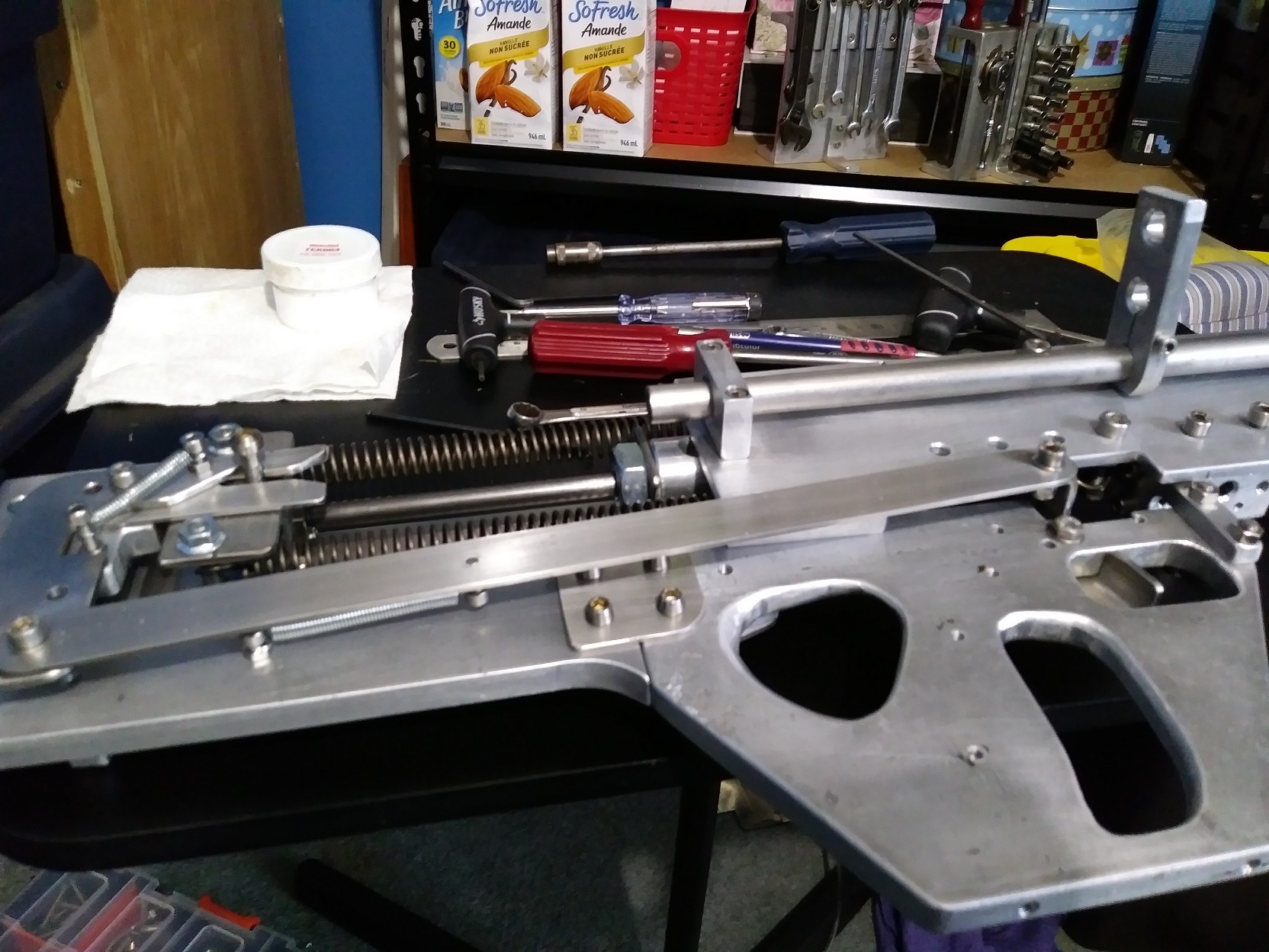

Sat May 02, 2020 4:25 pm
Got the locking and trigger release mechanism working.

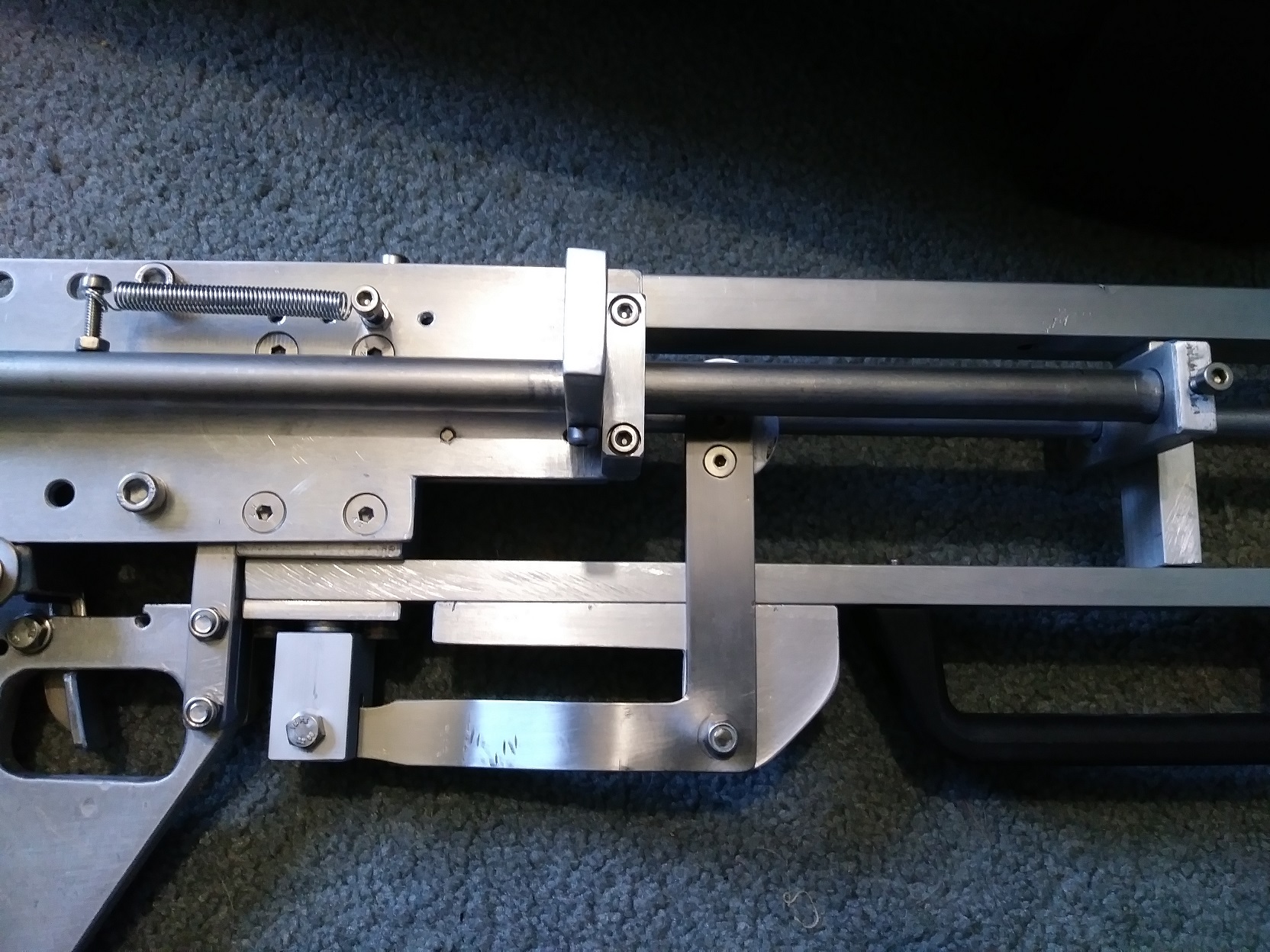

Sat May 23, 2020 5:03 pm
Getting the loading mechanism linked into the charging mechanism has been a headache but it is getting close.
Charge/load position, block on the charge rod moves about 80mm then hits the rounded piece on the L arm as it only needs about 20mm movement to move the plunger to the load position.

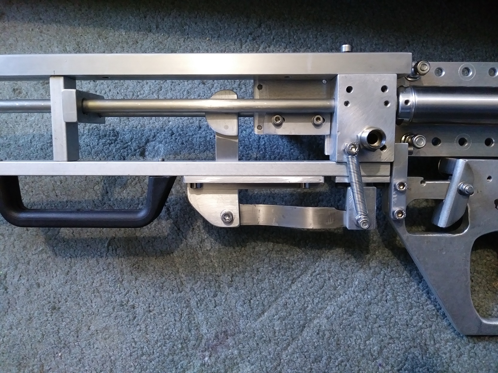

Sun May 24, 2020 3:36 pm
Mostly complete and had some test firing, loading works ok, just need the scope set up. Need to make butt plate and cover for the top spring.
