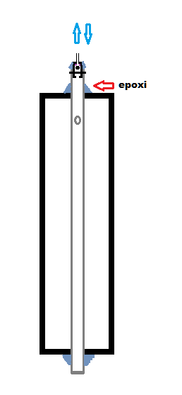

Thu Apr 28, 2022 4:22 pm
You can adapt this way. If you use only one one-way valve for charging and exhaust, one end of the long inner tube must be perfectly capped and secured. You can assemble everything outside, and then seal the inner tube with epoxy. In my opinion, if you secure the valve well with a pin, it is safer that way.
