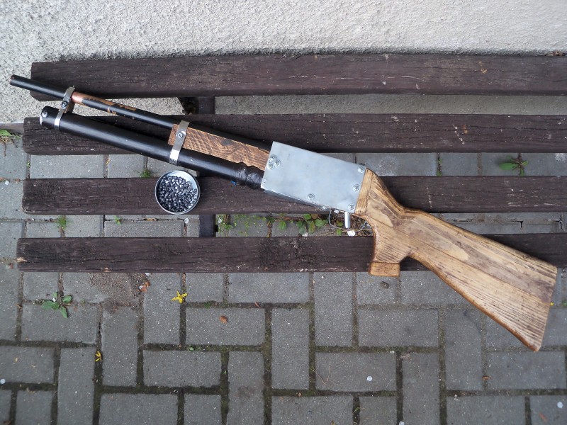

Hi all.
This is my 5.5 mm pellet air gun i made last summer. The paint wear off a bit, need a new paint job :cry: . It runs on 100-120 psi, QDV valve, PVC air chamber. Has a lot off power, pellets easily penetrates through cans and other stuff. This is my second build. I'm really happy about it :D Making a wooden foregrip (Brian the brain thanks for advise).
So how is it?
Video:
Old look
Old look
Fancy bolt :D listening to advice
Added metal plate on the back off the stock
New look

Thats a nice gun

Don't paint it, I love the look!reminds me of the BAR :) fantastic.
I'm interested in the internals, something like this? http://www.spudfiles.com/forums/paca-mk ... 21703.html

Thanks for the kind words :)
jackssmirkingrevenge http://www.spudfiles.com/forums/paca-mk ... 21703.html in fact this is exactly where i found the valve design. But i modified it a bit: placed a spring in it and made a different trigger mechanism with a lever.
BAR :idea: hmm could be a good look for my next project i working on.

It would be nice to see a diagram of the insides or perhaps some photos :)

Damn that looks GREAT! :D , well done = indeed some pics of how your own loading mechanism is ,would be great.

That's bad a$$. How much fps are you getting from that?

Thanks for compliments.
Added a diagram of the valve.
Loading mechanism is very simple you will see it how it works in the picture.
Blue the metal would be awesome but i have never done that before, need some research :)
FPS ? i have no idea how many, since i don't have a chrony sorry :(
Loading mechanism barrel slides front when i move the bolt

ignatorius wrote:Thanks for compliments.
Simple but effective, nice :) You dump all the air for each shot though right?
